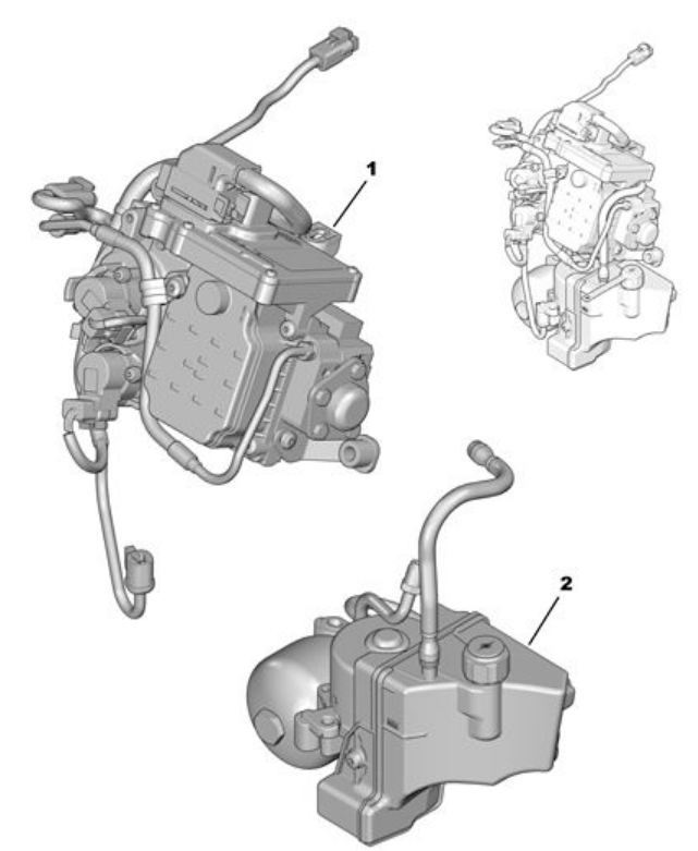

They can be calibrated by anybody with a suitable Lexia or diagbox diagnostic tool and the ability to use it. And of course the knowledge on how to use it. But the process is not for the faint hearted if things go wrong. This is according to the technical documents of which a rough translation I’ve already posted previously. Some will of course suggest that it just needs to have the bite points set by several takeoffs rests and starts.
It’s very much depends on what the original problem is. If it’s a simple clutch and dual mass flywheel change then there shouldn’t be any problem as long as the clutch biting point is initiated after the change as per normal. This is a technical requirement.
If the system has an actual fault in any of the hydraulic actuator systems then of course it becomes more technical in finding out what the problem is and that will very likely be a separate issue. So these faults are not necessarily the same for every owner to be fair.
