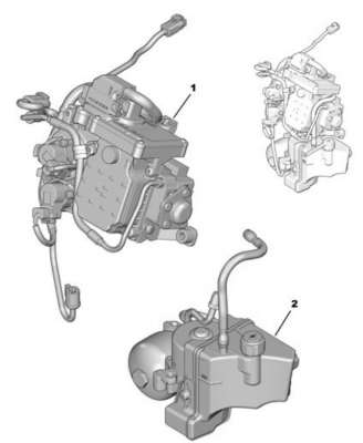

Thanks for the response Marc. Just a brief update although a possibly regrettable one.
I took it to said indy mechanic a few days ago, albeit the same day I got the responses here so I didn't actually see them until I had dropped it off.
I got the car back today after many days of being delayed and to great disappointment, the car is jerky in reverse and first gear. It bounces around and lurches wildly at the slightest touch of the accelerator and then goes away. I was told it just needs a few days to "learn?" erm....
The guy then tells me that its the actuator, shocked I said to him was this not a part of the repair and he replied 'no" and that this is another £1100 to fix.
The original quote from Peugeot included the actuator repair.
To note, to the best of my knowledge, I did not have this problem before, I only suffered the slippage problem.
With total regret, I am back here asking for some advice on this subject. What the hell do I do now?
I'm going to go back tomorrow and ask for the DPF and clutch that they took off, to check if there was any fault with it in the first place, or if it was just the actuator that was faulty from the start.

Did the garage realise they had to initialise the clutch engaging point? There is a specif procedure that needs to be performed when replacing the clutch.
If they didn't know this or where not capable of doing it they should not have undertaken the work in the first place in my opinion and therefore you should get in contact with the Manager to tell them this. There may be nothing wrong with the Actuator, but it is essential that the following is performed and they should have known that they need Diagbox diagnostics to do this, which is what Peugeot use.
I don't have the English, but this is a translation, so if a few of the words are a bit weird you know why:
viewtopic.php?f=3&t=60988&hilit=stop+start#p586730
So sorry to hear about this.

Hi, I dont think you have a problem with the actual gearbox as these are the standard 6 speeder's.

Re: 5008 - 6 Speed Piloted Gearbox - Needs Rebuild
They can be calibrated by anybody with a suitable Lexia or diagbox diagnostic tool and the ability to use it. And of course the knowledge on how to use it. But the process is not for the faint hearted if things go wrong. This is according to the technical documents of which a rough translation I’ve already posted previously. Some will of course suggest that it just needs to have the bite points set by several takeoffs rests and starts.
It’s very much depends on what the original problem is. If it’s a simple clutch and dual mass flywheel change then there shouldn’t be any problem as long as the clutch biting point is initiated after the change as per normal. This is a technical requirement.
If the system has an actual fault in any of the hydraulic actuator systems then of course it becomes more technical in finding out what the problem is and that will very likely be a separate issue. So these faults are not necessarily the same for every owner to be fair.

Hola, soy nueva por acá. tengo un Peugeot 5008 2019, 1.6 aisin 6 gasolina. (Colombia)
Le hicieron reparación de caja (kit completo, de discos, empaques, bandas entre otro) reparación de par. Los selenoides los limpiaron con ultrasonido.
Al subir todo, el carro presenta tirones de 1 a 2 y la reversa está muy desbordada.
Dicen que con el diagbox solo escaneas, ingresan por piezas de recambio, borran códigos y ya queda. Pero sigue presentando el mismo problema.
Se debe hacer proceso de auto adaptativo? Puedes indicarme cómo se hace este proceso o los pasos que debo hacer? Si tienes algún video o fotos te lo agradezco
GiveMeABreak wrote: 19 Mar 2019, 18:05 Aaggghh!
The Stop & Start system is dependent upon lots of factors coming together. It may be a coincidence, or, as a result of being in the garage and having short runs, being started and stopped whilst in there, insufficient running time, low battery etc. etc. - see conditions for Stop Start system in my 2 posts here:NOTE: This learning is done by a dynamic test of the vehicle. Perform this procedure in the following cases:Preliminary operations: Perform the following operations; Using the Diagnostic Tool (Diagbox):
