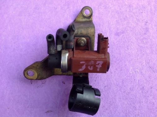

where is this located on the 307 1.6 hdi 90bhp year 2007

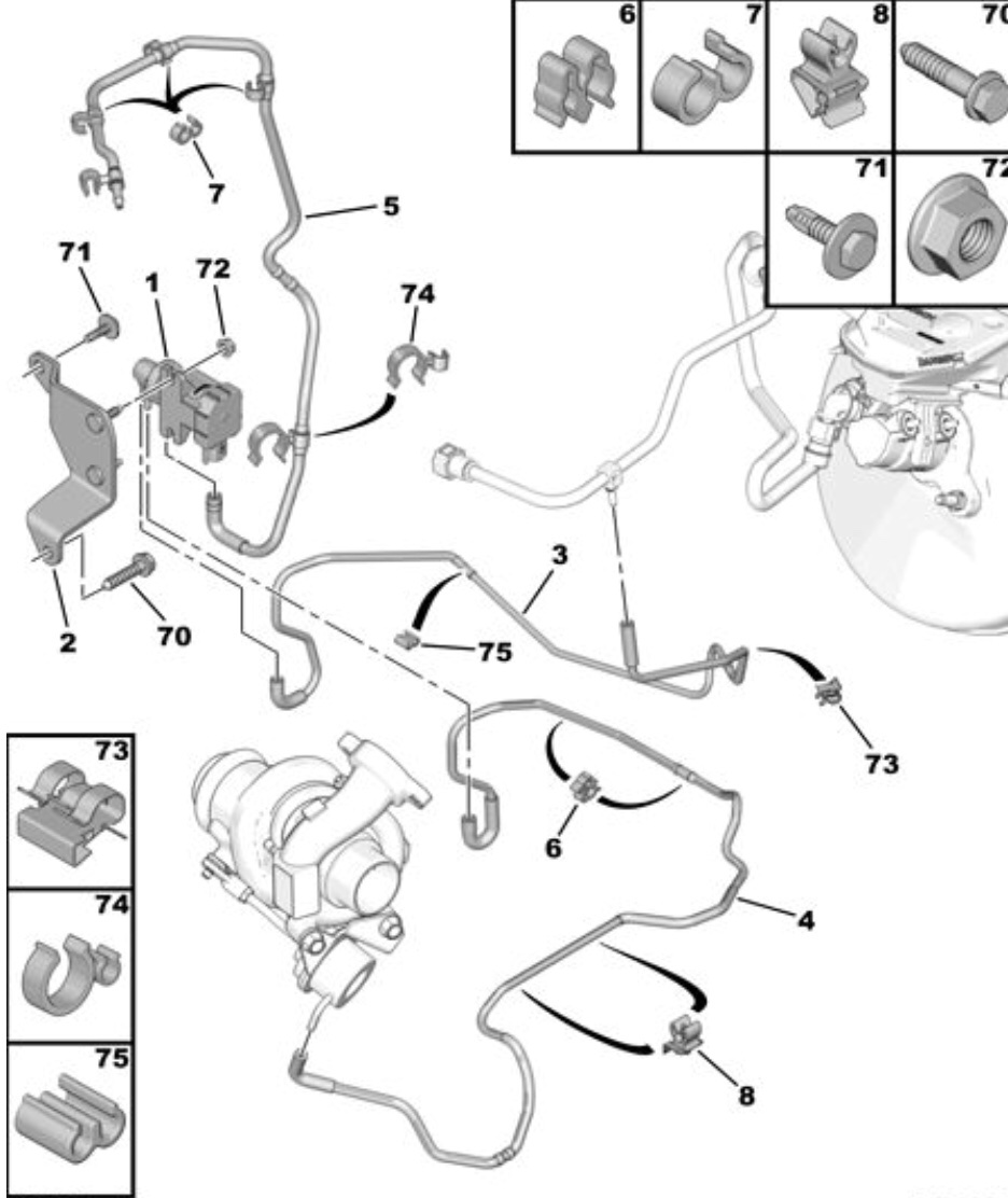

It looks very much like the Turbo Vacuum Solenoid Valve (item 1), you can see the 3 air unions (3, 4 & 5) on the diagram that correspond to the pipes that have been cut off in your picture.
