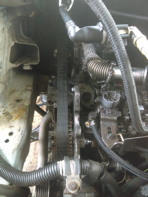

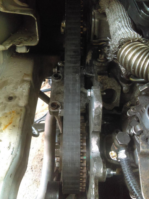

except now theres the problem...the pump pulley doesnt line up with the cam pulley, throwing the belt off by 4-5mm..
belt has been refitted, tensioner checked etc..everything ..
im at a loss whats causing this...wrong pulley? a change in pump bracket etc??
please see pics and let me know what you think,
or if theres any guides to the bosch conversion on a dw8 engine?

While I have not actually done this conversion myself, it is very common over here.
Pretty much everyone understands the Bosch pump, but the Lucas one seems to operate by witchcraft.
I wonder whether you may have omitted a spacer when refitting the pulley.
I'll ask some of the guys who have done it, during the week, and see if any of them have come across this.

Hi I've tried everything now ..had pump off today and swapped pump bracket with one off a Peugeot 206 w reg thinking it might be slightly different, however it's still the same issue ....

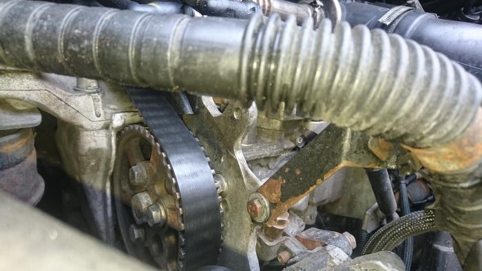

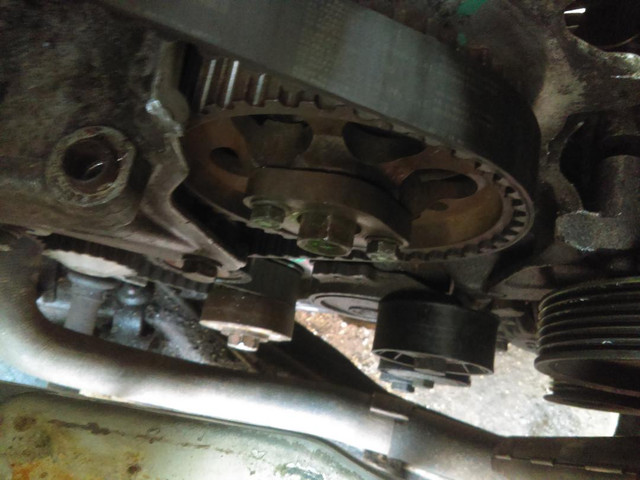

That said, I did end up with my belt like this after a few months
Which looks like mine might have started out like yours. They did fix it and it's been fine since. I'm not sure what they changed though

That looks like it's running off centre due to a damaged/worn tensioner or idler (or even water pump, though that'd likely piddle everywhere). Also I seem to recall a metal guide plate that fits on the crank sprocket behind the pulley to help stop the belt wandering off track, if my memory isn't playing tricks, could this have been omitted on reassembly?
Make 100% sure all the tensioner nuts/bolts are tightened as they can be a bit of a fiddle to reach and if you don't have the spring retainer you're fighting against that too.
Only difference the injectors ought to make is to timing adjustments as there's IIRC about 20-30 bar pop pressure difference so lower pressure injectors would = advanced timing and vice versa

Seems a bit of an over-simplistic suggestion (I've never done this myself)
...but sometimes the obvious can be overlooked

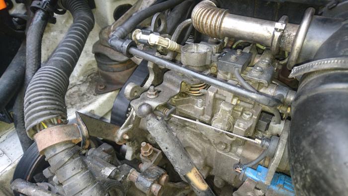

Can you push the belt further on to the Cam Pulley so that its at the NS extreme of that pulley, which might put it within the OS boundaries of the Pump Pulley
Looks from your Pic 2 that there's some room available on the Cam Pulley, perhaps as much as the 4-5mm you're 'short'
