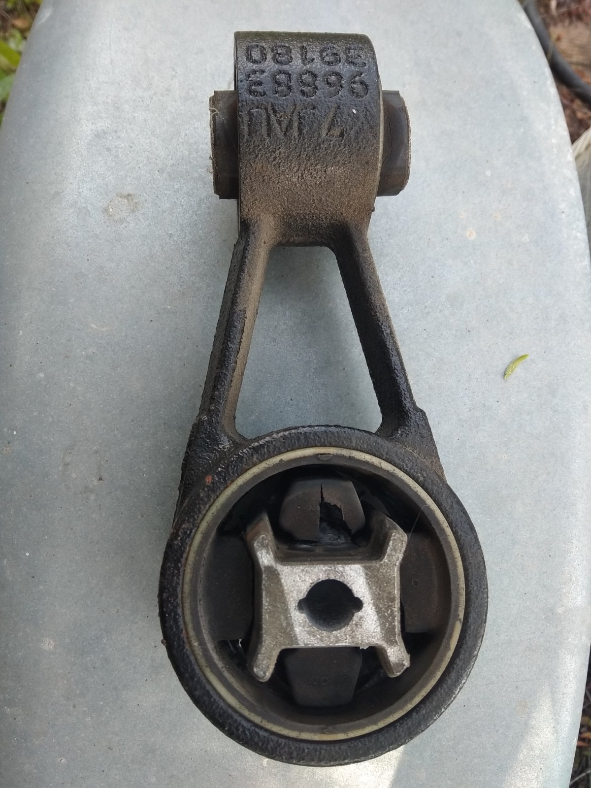

What is the purpose/function of this part?
Unread post by atr »
Hi
This part is a part of the upper engine support (right side) of the C5. as you well know, it is located above the engine support, connected to the vehicle's body. I assume that its function is to dampen possible fore and aft movement of the engine. please correct me if I'm wrong.
Thanx.
Avi
xf1ref
Posts: 226
Joined: 20 Feb 2012, 05:42
x 12
Re: What is the purpose/function of this part?
Unread post by xf1ref »
Hi, is one of two anti torque mounts.
Posts: 11778
Joined: 02 Apr 2005, 16:11
x 1240
Unread post by Peter.N. »
Yep, in addition its to damp fore and aft movement of the engine allowing the mountings to be softer.
atr
Posts: 314
Joined: 09 Oct 2010, 05:02
x 6
Thanx. I have to replace it along with the engine support.
xf1ref
Posts: 226
x 12
Check also the one under the engine. That one is more affected by the fore and aft movement of the engine.
