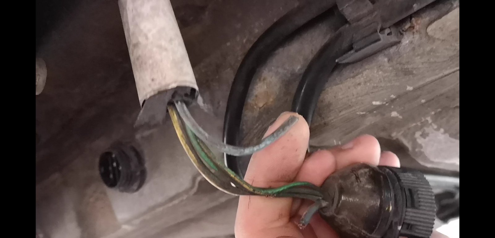

Found the problem. Broken fuel pump wires.
Broken fuel pump cables.

Well found. Presumably you had to take a chance and drop the tank to find that.

Surprisingly enough, this was on the bottom of the tank. I was lucky to have found that. Still won't start though, think that a combination of air in the system and a weak battery is the cause now.
