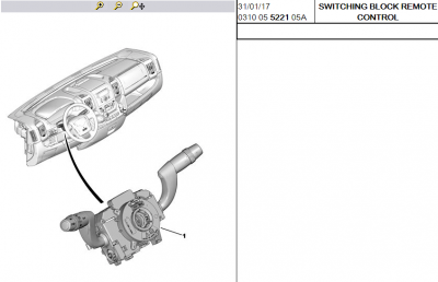

I did check again with your VIN and it still does not even list a part number for your particular switch block as you can see from the picture:
You have quite a basic system, - no theft alarm, no side airbags, no ESP, no passenger airbags, basic digital MP3 CD radio, single A/C - so no bells and whistles.
The other switching block remote control modules under the steering wheel are huge depending on fitted options. To give you an idea, this is the listing against one such module for part Y735679008, so that you can see the variation.
I'm not saying it cannot be done but I would suggest your best bet is to speak to a dealer to see if there are any specific things you need to be aware of and if they can recommend the correct module, what coding is required and what other additional equipment you may need and also whether any BSI downloads are needed.

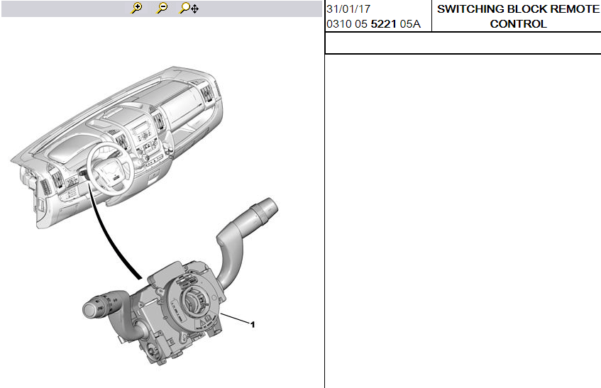

There are a stack of other modules all dependent upon build date and options. As these are Fiat / Ford vehicles, they are not truly PSA, so have different electronic architectures and different equipment / options and the like. So I can't actually help you with this as these are too cross-platform and miles away from a pure PSA vehicle as such that share the same electronic systems / head units and other components.MARKING Y735679008
