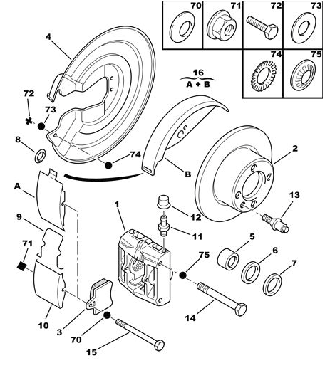

I want to ask you if the rear brake calipers from a xantia station wagon with the 251mm disks and 36mm piston diameter are a bolt on mod on a xantia hatchback.

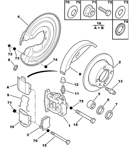

Hi Panos
For a series 1 & 2 Xantia they have the same rear calipers, but the saloon and Estate do have different types of claipers and part numbers - the diagrams are below if it helps.
| Xantia Series 1 & 2 Saloon Rear Caliper | Xantia Series 1 & 2 Estate Rear Caliper |

Re: Xantia break rear calipers on hatchback
Estate rear arms are different as well aren't they?
