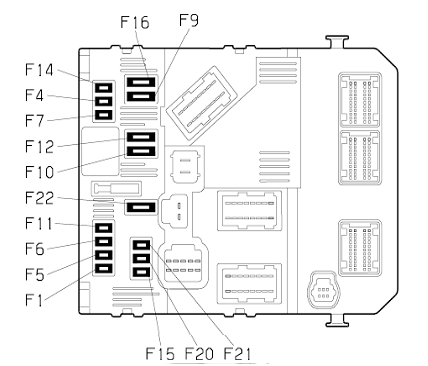

Obvious Fuses to check:
BSI Fuses
F4 (switching module under the steering wheel (COM 2000) - clock - multifunction screen - audio system) - Ignore if clock / radio is working)
F14 (switching module under the steering wheel (COM 2000) - engine compartment fusebox panel - air bag and pre-tensioners control unit)

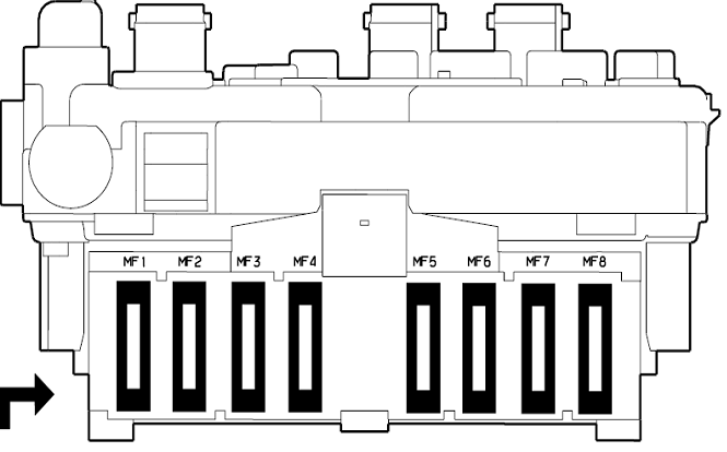

Maxi Fuses
Maxi Fuses MF4 & MF5 (Power to the BSI)

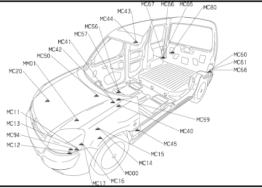

Earth Locations
BSI Fuses
Maxi Fuses
Earth Locations
