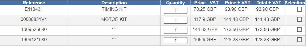

As for timing - here are the official offerings from Citroen parts - I've included the belt and pulleys kit and secondly the same but with water pump too:
Just need to add the labour....
E118431 - Non OEM kit (includes pulleys and tensioner rollers)
0831 V4 - Orig as above
1609525680 Original Kit including water pump
1609121080 cheaper kit inc. water pump

Not a bad price that actually Marc,128, I looked on ecp and they quoted 97 for the belt kit and 60 for water pump..
