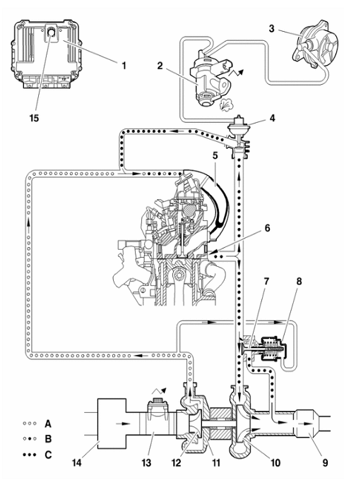

From what I can see this engine doesn't have a solenoid for the turbo boost - it uses a mechanical vacuum capsule. So I would check you are getting enough vacuum from this.
| Reference | Designation |
| 1 | injection ECU |
| 2 | Recycling regulation electrovalve (EGR) |
| 3 | vacuum pump |
| 4 | Exhaust gas recycling valve (EGR) |
| 5 | Air inlet manifold |
| 6 | Exhaust gas manifold |
| 7 | Boost pressure waste gate : Pressure-controlled |
| 8 | Pneumatic control capsule for the waste gate (on turbocharger) : Pressure-controlled |
| 9 | Catalytic converter |
| 10 | Exhaust turbine |
| 11 | turbocharger |
| 12 | Air inlet turbine |
| 13 | Air flow meter + Air temperature sensor |
| 14 | Air cleaner |
| 15 | atmospheric pressure sensor (integrated in the injection ECU) |
- x 6961

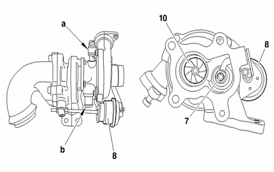

Some more info on operation:
The turbocharger consists of two separate chambers.
The turbocharger consists of the following components:
At rest the waste gate is closed.
The boost pressure is regulated according to the air pressure in the inlet manifold.
Operating phases once the pressure value of the pneumatic capsule ( 8) has been exceeded:
| (7) Boost pressure waste gate. (8) Pneumatic control capsule for the waste gate: Pressure-controlled. (10) Exhaust turbine. " a": Pressurised oil delivery (evacuation of gases and cooling). " b": Oil return. | (7) Boost pressure waste gate. (8) Pneumatic control capsule for the waste gate : Pressure-controlled. (10) Exhaust turbine. (12) Air inlet turbine. " c": To the inlet manifold. " d": Gas from the exhaust manifold. |
- A chamber connected to the engine exhaust function
- A chamber connected to the inlet function
- A turbine and a compressor, connected by a shaft
- The boost pressure waste gate opens
- The exhaust turbine speed decreases
- The boost air pressure decreases
- The decrease in the boost pressure causes the boost pressure waste gate to close.

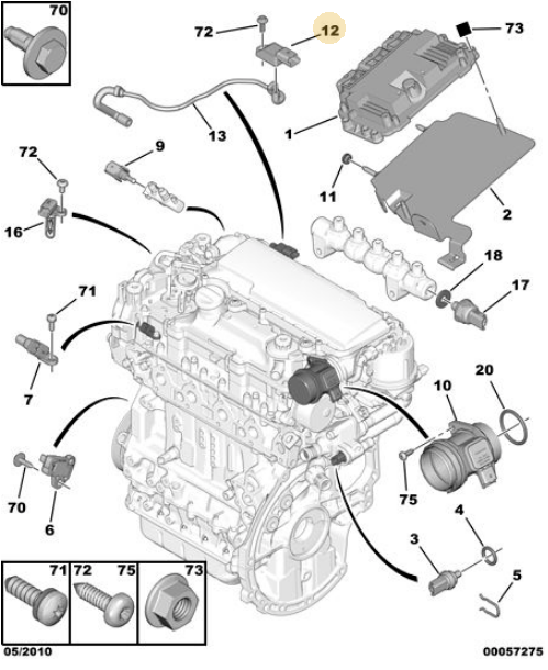

doctle wrote: 05 Feb 2019, 11:17 There is no plug that goes to 12 sensor on my car could this be the problem?
Thanks
Paul
Is #12 the sensor you referred to by the air filter? If so, I stand corrected and think #10 is the MAF.
And yes, if it's not connected, it most likely is the cause of the fault.
MikeT
- Posts: 4808
- Joined: 11 Jun 2007, 16:17
- x 232
Re: Turbo Boost sensor
GiveMeABreak wrote: 05 Feb 2019, 11:14 It refers to the Air Pressure sensor as I mentioned above:
I think we're at cross-purposes here, Marc... The only "boost control" affected is from manifold air pressure acting direcltly on the wastegate, which simply bleeds off exhaust gas once a certain pressure is reached.
In this instance, the MAP plays no part in controlling boost. It just reports the pressure to the ECU (presumably for fuelling and DTC purposes).
- x 6961
(10) is the MAF, (12) is the Intake Air Pressure Sensor (manifold), but the turbocharger pressure is regulated by the waste gate valve.

GiveMeABreak wrote: 05 Feb 2019, 11:26 There should be the measuring pipe (13) on the diagram, and also an electrical connector. This diagram is from your VIN, so the sensor will be doing diddly without an electrical connection and that will throw the engine ECU in to compensating and giving you the issues I suspect.
Have a good check around there to see if it has been disconnected accidentally (or otherwise). It may have been taken off during some other maintenance and forgotten to be reconnected - it happens - even by the dealers!
I suspect I may have tucked the wire somewhere "safe" when I changed the injector seals. The air filter housing is a tight fit. I will go hunting if the rain stops if not I will have to make a tent from tarpaulin I will report back, thanks guys
