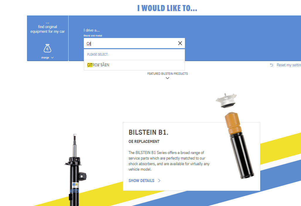

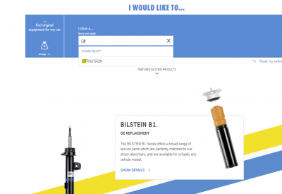

It doesn't help that on Bilstein's own site, they have a bug in the parts section, so it won't even recognise Citroen as a brand. Secondly, they supply standard and performance and off road variants - they do have an OE section for original fitment, but the database is having issues as you can see when you try to type Citroen.... it won't accept it, so it's a waste of time.
Click to Zoom I've just called Bilstein in the UK and was passed on to a very combative sales chap that deals with this - who tried to tell me that you need to go to the sales catalogue as the only way to fix this!!
I told him basically no - and that if they are providing a website, then it should work and to stop being so defensive as I was only doing them a favour - most people would give up and go elsewhere - then he seemed stop, take a breath and pay attention to what I was saying!
So he is going to pass it on. Honestly, this is what you are up against - some companies cannot take constructive criticism when you are trying to help them out!
