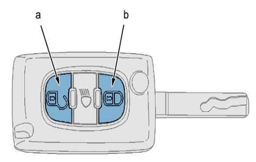

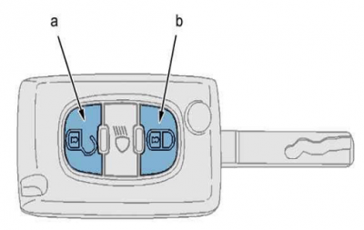

| Reference | Description |
| "a" |
| "b" |

It's only the Tourer which has the centre button for releasing the tailgate. The saloon operates the headlight as shown in the drawing.
Now, what you're saying about the short/long press is interesting. When I first got my X7 I complained to the dealer that the centre button didn't work. It turned out that I was only giving the button a short press and it required a long press. I actually find this a PITA and if there's a way to flip it to accept a short press I'd be happy!

Yes I just put a generic fob up to illustrate the buttons.
But as said I have looked at the BSI configuration and there is no delay, timing or other option I can locate for the middle button tailgate setting.
