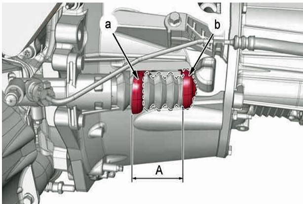

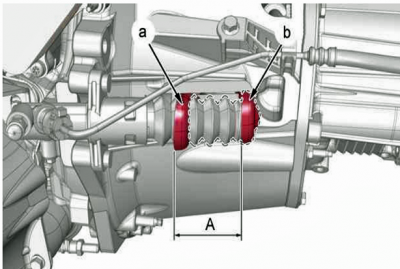

Clutch fork :
"a" : Applied position
"b" : Released position
Press the clutch pedal.
Measure the travel "A" of the hydraulic slave cylinder or of the clutch cable.
Compare the values read with those in the tables below.
Note: you have the ML6C gearbox.

Check the travel of the hydraulic slave cylinder or of the clutch cable, from the declutched position to the clutched position.
Note: Two people are required to perform the following operation.
Clutch fork :
| Travel "A" | ||
| Type of gearbox | Cable control | Hydraulic control |
| ML5C - ML6C - MLGU | Not equipped | 20 mm |
