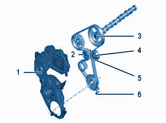

I think you mean this little lot:
| Reference | Designation | Tightening torques |
| (1) | Bolt (Protective cover ) | 0,5 daNm |
| (2) | Bolt (Roller tensioner ) | 2,3 daNm |
| (3) | Bolt (Camshaft pulley ) | Pre-tighten to 2 daNm Angular tightening to 50° |
| (4) | Nut (Roller tensioner ) | 3,7 daNm |
| (5) | Stud (Roller tensioner ) | 1 daNm |
| (6) | Bolt (Shift prevention bracket) | Tightening to 0,6 m.daN |

These are the settings for your engine with and without A/C so I just put them up as they are not separate.
We’re not dealers of course, but try to help people out voluntarily. Peoples’ terminology is different and that is half the battle, but glad you have what you want.
