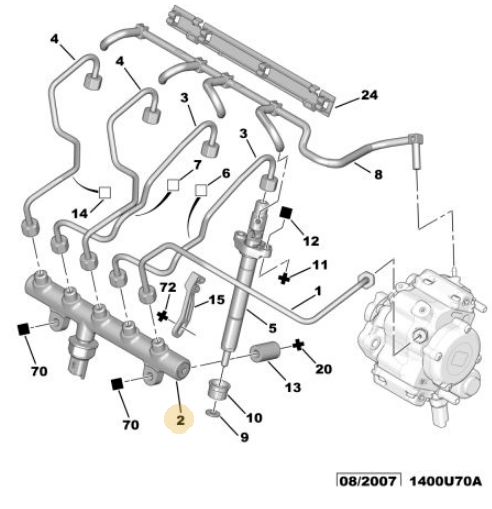

Grahambeveridge225 wrote: 01 Feb 2019, 17:56 Can anyone shed light wher the pressure sensor is located so I can have a look? Need to go to the garage for a recheck grrr
The bad news it that PSA do not sell these separately and they specifically recommend these as not being removed from the supply rail. Which is why they only supply the rail.
Although you can get these aftermarket, I am aware from previous attempts by others that they have had issue on reassembly...
Item (2), and the pressure sensor is shown at the bottom as part of the rail.
The part for the rail is 1570L9 and is £265.06 from Citroen inc. VAT for the complete rail with sensor, so I do hope the Italian tune up sorts it :wink:
