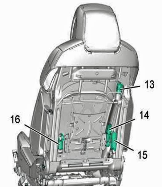

The massage seat function works for less than a second and then goes off. On a local Australian forum, a post suggested adjusting the lumbar setting to fully on, as this might release the 'rollers' - but that hasn't worked. Any ideas?

deckoil wrote: 27 Jan 2019, 23:55 The massage seat function works for less than a second and then goes off. On a local Australian forum, a post suggested adjusting the lumbar setting to fully on, as this might release the 'rollers' - but that hasn't worked. Any ideas?
There are 2 motors used for the massage function - essentially these are the same motors used for the lumber support horizontal and vertical adjustment. The switch moves in 4 ways, so I would suggest you first hold it fully up, or try fully down, then try left and right in order to free the rollers if this is the issue of course. Note: always do this with the engine on, but be aware continued use will result in the overload protection kicking in if the motors get too hot.
(14) Lumbar vertical adjustment motor (HIGH / Low).
(16) Lumbar longitudinal adjustment motor (Front / Rear ).
