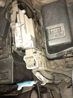

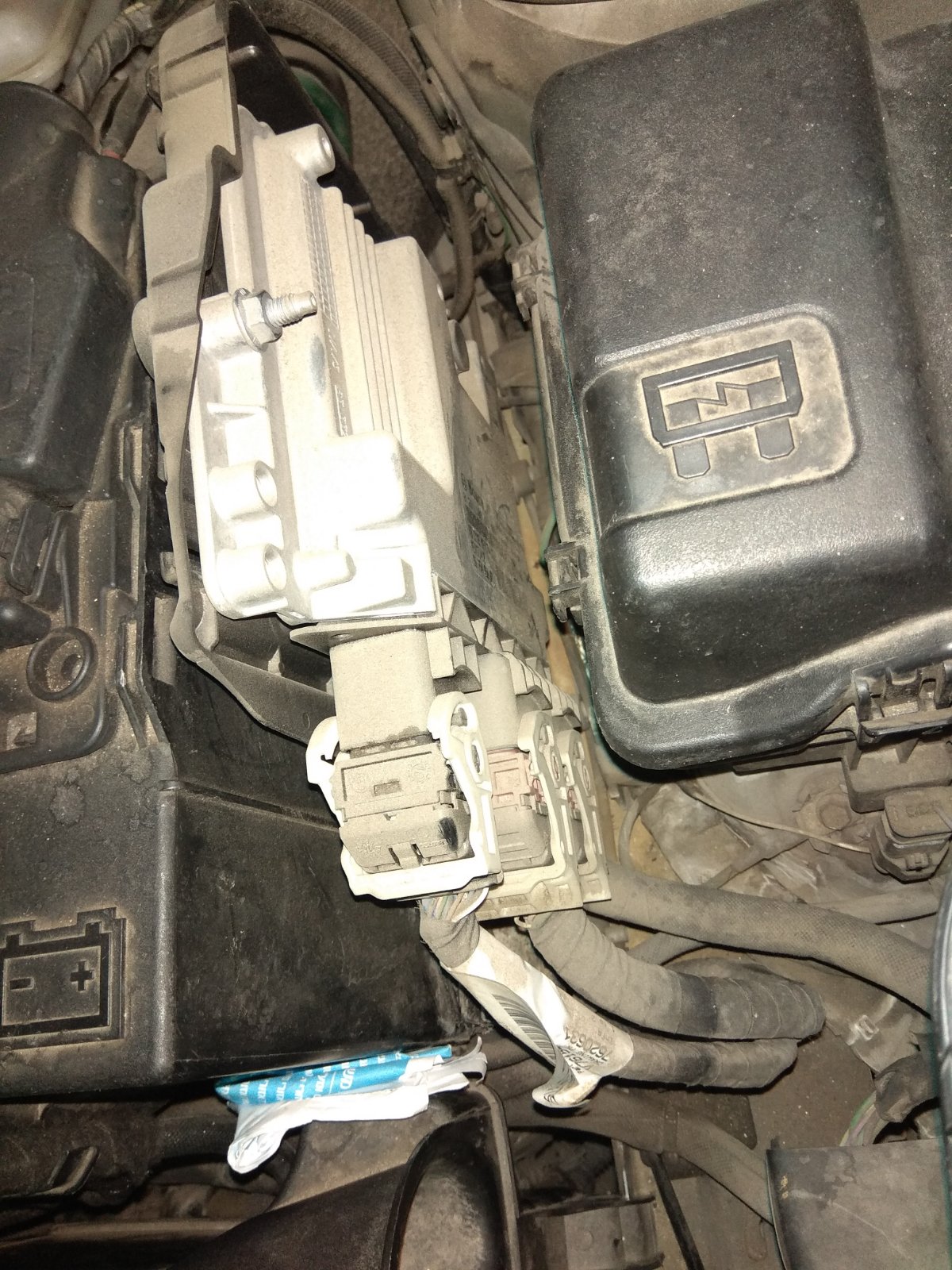

It seems my low speed fan on my Citroen C3 1.6 120 VTI 2012 doesn't come on, as I read the OBD coolant temp at around 97c, I even got to 102c (I think the high speed is working, but haven't seen it in action,
just that I never overheat, and the temp drops at around 105c in the OBD sensor reading).

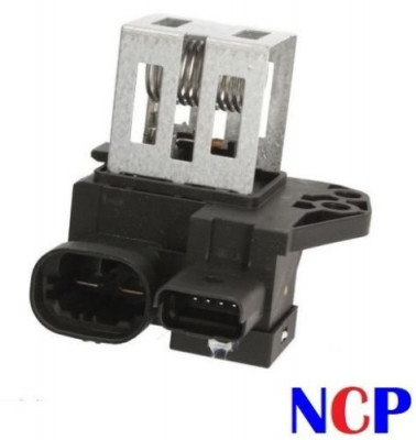

To test the fan, I removed the 2 pin plug from the resistor/relay unit pictured above, and shorted the 2 pins, the fan started, so it is ok
I tested the resistor/relay unit on another friends car, and his low speed continued to work so this unit seems ok.
So what else can I check?
Is the ECU only one controlling this? Is the ecu directly wired to the 4 pins?
Is there another temp sensor but the one on the thermostat housing? If so, which one is reported on the OBD?
And about this relay:
Is this unit just a relay that connects the resistor in series to the 2 pins? What are the 4 pins pin outs?
Can it short it as well - high speed mode or is that another relay? If so where's the high speed relay?

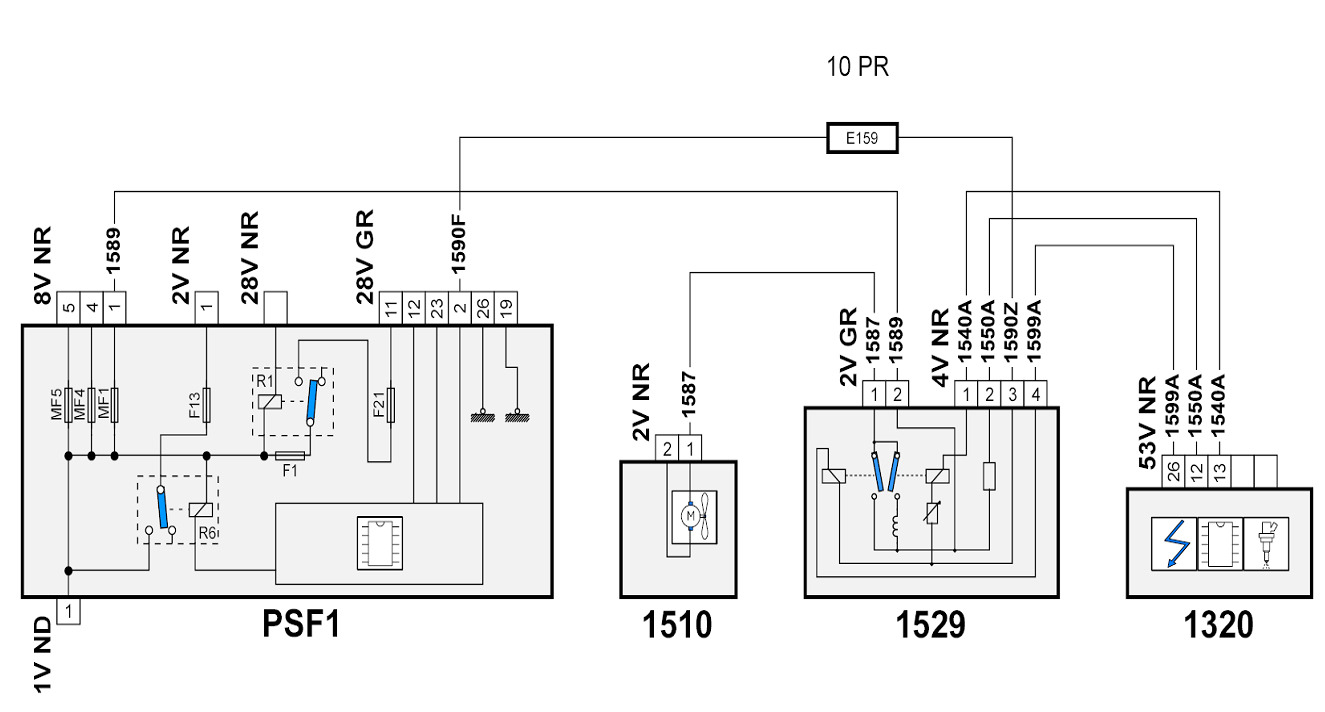

The fan (1510) is controlled by the Fan Assembly ECU (1529). Both speeds are controlled by the Engine ECU (1320).
The fan ECU gets power from the engine fuse box (PSF1) via Maxi Fuse 1
Pins 1, 2 & 4 are connected to the engine ECU. 1540A is Fan control (1), 1550A is Fan Control (2) and 1599A is the Fan Diagnostic Info.
So you should have a fault code if there are any issues, assuming you have a proper diagnostic tool (Diagbox is recommended).

Finally! the correct schematic
All I found online were older or different designs. Thanks a lot!
So the relay/resistor unit (1529) has two relays, both the high (pins 3-4 energized) and low speed (pins 3-1 energized).
Pin 2 (1550A) seems to be a feedback back to the ECU, that ones of the relay are closed, did you mean this is the Fan diagnostic not 1599A?
What the function of 1590A wire? Why is it connected to fuse box via some chip and what is E159? can I assume it works and has some constant potential (GND or 12v) and pin 4 and 1 control the fans - if high speed works, since it's shared with both.
According to this schematic, and my test of the 1529 unit in another car (low speed works) and assuming high speed works, seems like either 1540A wire is broken, or the engine ECU (1320) doesn't properly energize it.
Is there a guide how to disassemble the ecu cover so I can test continuity? (EDIT: ok by visual inspection, you remove the 2 plastic clips for the upper cover, then the whole unit can be lifted up with it's side cover, then disconnecting the ~3 plugs).

Re: Low speed radiator fan not working on Citroen C3 120 VTI
1510 is the actual FAN not the relay.
1529 is the Fan Assembly ECU which contains the relays.
I would be VERY cautious about dismantling the engine ECU - anything goes adrift there and you risk the car not starting. There are no instructions on disassembling these I'm afraid - that's what the diagnostic tools are for to determine any faults reported by the engine ECU. I doubt there is anything you can do inside it and I really wouldn't recommend you do, these are very sensitive.
- 1599A: Fan unit diagnostic info
- 1590: Fan unit relay power supply
- 1550: fan control 2 (-)
- 1540: fan control 1 (-)
- 1589: Fan unit module power supply
- 1587: left fan assembly supply

Does fan control 1/2 (-) means it supplying low voltage (GND) to the relay?
So, should I test continuity with ECU plugged it?
Regarding the naming again, how is pin 4 on the Fan control unit (1529):
I mean it's only connected to the the high speed relay unless they sample both ? It's just that pins 1 and 4 seems symmetrical in controlling both relays.
While pin 2 seems to sample the relays status from the big pins 1 and 2 if the relays close.

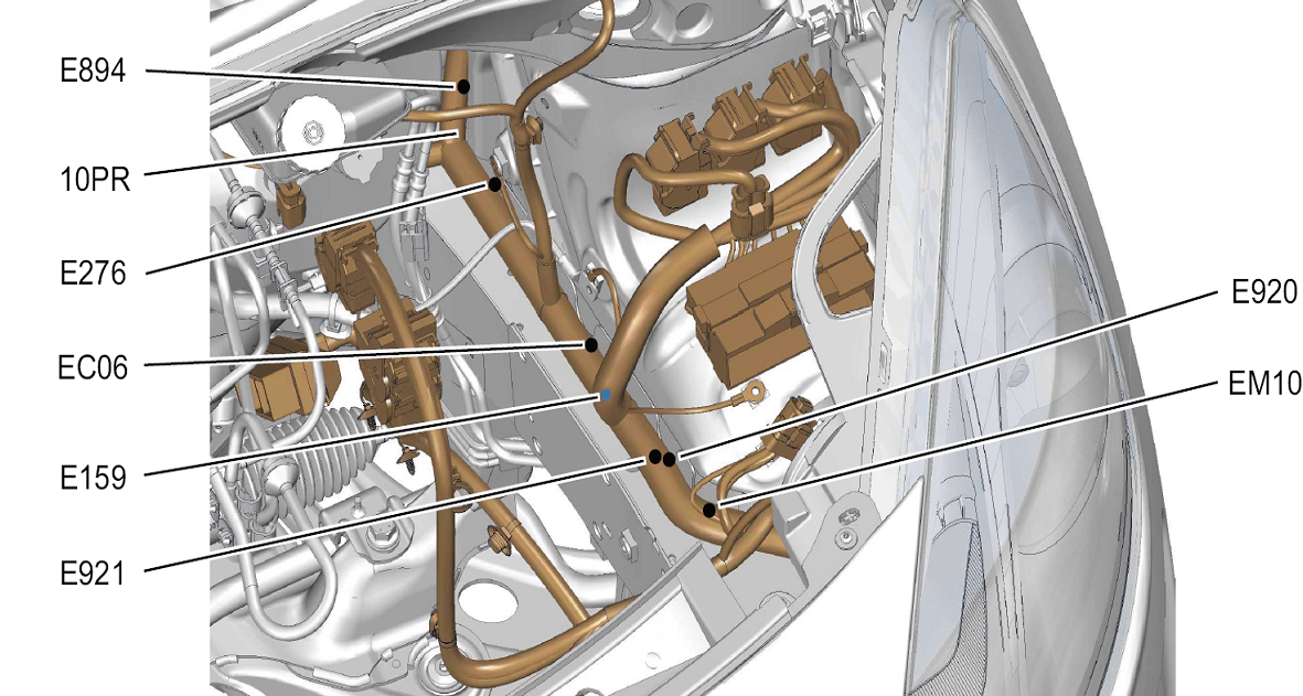

Here's the full part of the schematic relating to the Cooling System for you.
12A6: coolant outlet housing
The Diagnostic probably just informs the Engine ECU whether the Fan is working at single or double speed when commanded to do so.

HI,
Does anybody have information what kind of volts should come to the 1529 on cables 1540A and 1550A.
I get the following
Power on (engine not running)
1540A 3.5V
1550A 1.3V (this I am suspecting to be wrong?)
1590A ~12V
1599A ~12V
Mikko
I get the following
1540A 3.5V
1590A ~12V
1599A ~12V
Mikko
