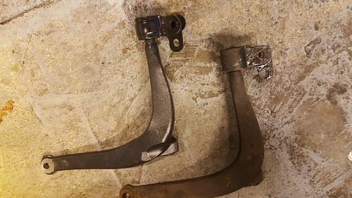

Just before Christmas I was returning from the workshop home and on rounding a corner there was a metallic 'crack' sound. The rest of the journey (25miles) seemed uneventfull albeit with the slight knocking on taking up drive. I couldn't see any obvious failing joints of any sort on either front axle. In the 3 years I've ran Auld Katy the Xantia I replaced both front ball joints, drop links, lower arm bushes and P Bush, RH driveshaft gaiter and more recently, the strut tops (see other recent thread) So I just couldn't think what it was.... engine mount?

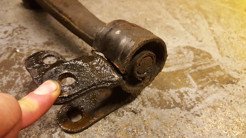

Well it wasn't any angine mountings and as it got gradually worse over the following week I got the chance to have a proper look and found thet one of the P-bushes (OSF) had failed completely! It was not the rubber bush but the steel surrounding has snapped completely.

I fitted these and the front bushes to each suspension arm completely by the book including their orientation with relation to the arm's horizontal position. Well, as far as I know I did the job right.

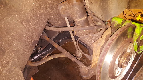

I opted to replace these with 2x full new front arms because I just wasn't sure about some mistake I could have made (and the new arms were only a small leap further in cose than a full new set of bushings)
Image20181206_202542 by Graeme McNulty, on Flickr
..I love a new bit in an old car...

Anyone have any views on this failed P bush? yes, it sure was off Ebay but was from what I thought to be a reputable brand, Bilstein I think they were.
If I did something wrong on the installation of these - what would it have been? Incidentally, the NS P-Bush was completely fine when I removed the other arm.

That looks like a stress fracture and, located at a weld like that, probably just a once off. The join may not have been in perfect alignment and when you tightened it up it could have been under tension, so the normal additional stress from use exceeded the elastic limits of the metal. Welds don't bend or stretch, because they're too hard and brittle, so if you exceed their elastic limit they break.
The forces involved here are pretty big, so you did well not to lose the track control arm on the road.
