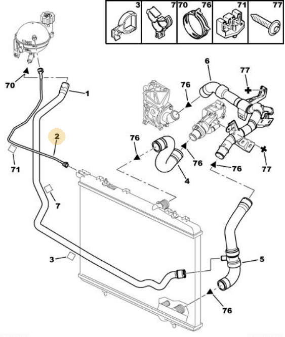

Could you give me the part number for the (Brittle and narrow) pipe from the top driver’s side of the rad to the header tank please...

Re: 307 1.4 Radiator removal
If it's the degassing pipe (2) it is 1323Z9 (£7.27 inc. VAT) from Peugeot
If the Expansion Chamber Water Hose (1), then 1323EX (£21.77 inc. VAT) from Peugeot

Brilliant, thanks Marc, it’s number 2...
