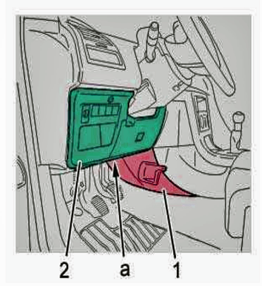

A lot less involved than on the B7, as the inflation ECU and steering column parts have to come off for that - but a lot easier on the 180:
Remove the following components:
  • Console side trim ( 1)
  • Trim under steering column at "a"
  • Lower moulding (2)
Note: Remove the steering column air bag (according to equipment).

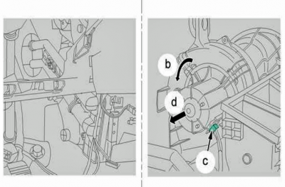

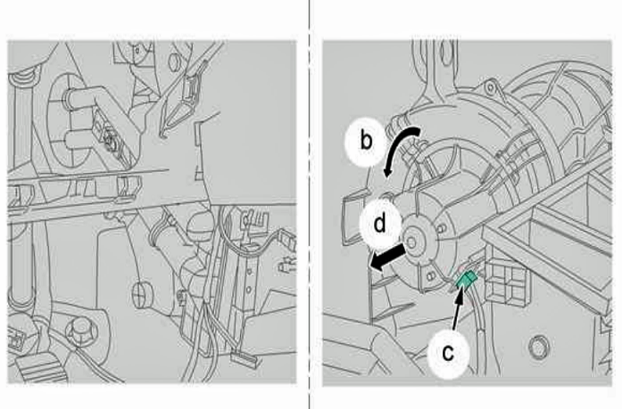

Removing
  • Unlock and disconnect the connector at " c".
  • Detach the blower by rotating it (following the arrow "b").
  • Remove the blower (following the arrow "d").
Refitting
Refit the various components in the reverse order to removal.
Check the operation of the blower.
