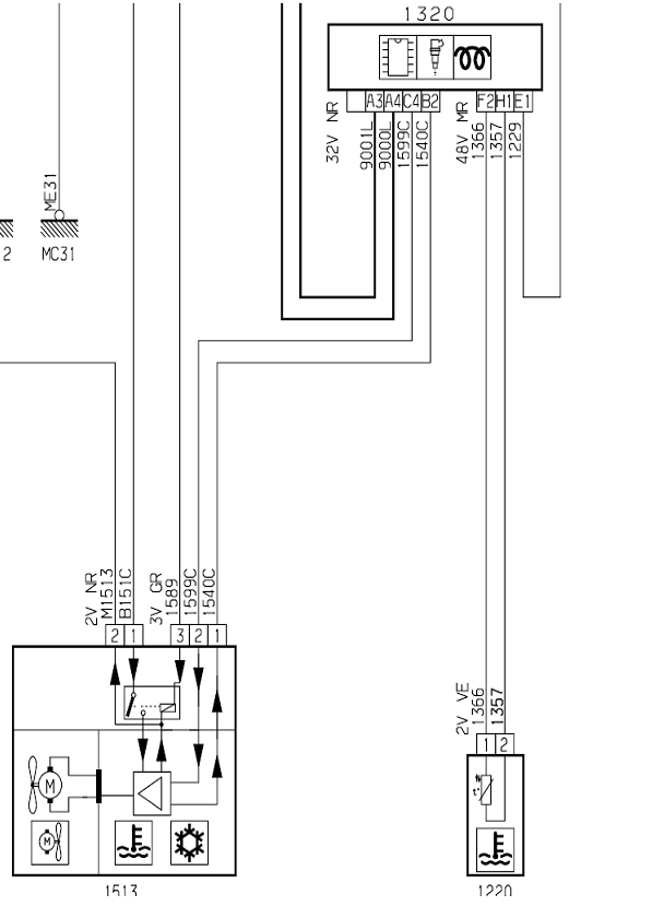

P0483
Description of the fault code: Cooling Function Incorporated in the ECU ( electric cooling fan unit): Open circuit.
Description of the diagnostics: The line is in open circuit for more than 5 seconds.
Conditions of activation of the diagnostics: Consult the associated contexts for the Pcode forwarding conditions.
Conditions of disappearance of the fault: Ignition on.
Down-grade modes if fault present: Diminution of the coolant temperature thresholds to cut the aircon compressor.
Switching on of the warning lamp and/or warning message: N/A
Main customer complaints likely:
Pre-heating relay circuit: Coherence; Relay supplied and glow plugs not supplied - common error and won't go into detail on that.

Given all you have said, I am beginning to suspect the BSI is at fault as all of these lighting issues feed back to it. Even the rear lamp unit supplies for the fog lamps specifically have separate left and right feeds for each fog lamp back to the BSI. The fogs should not operate without the lighting of the main headlamps. The common denominator in all your lighting issues would point back to a problematic BSI.
- x 6955
Re: C5X7 spawn of Satan !
Having said that, there is also one other common issue - and that is Maxi Fuse 1 in the engine compartment Fuse Box. MF1 is responsible for the Fan (50A), plus the additional heater burner (where fitted), air conditioning and fog lamps.
Maxi Fuses 4 & 8 are also concerned with BSI supply.
Maybe it is worth a look at the maxi fuses for oxidation / condition.....

- x 6955
Wheeler is right - it's not talking about an ECU=cooling fan , but the Injection ECU control of the Engine Cooling Fan. You can see the Fan (1513) to Engine ECU (1320). The other 2 wires are the Fan High Speed and Fan Module Power Supply wires to the Engine Fuse Box.
@ Robin: Yes they do, but in most cases they are woefully inadequate leading to overheating issues - luckily my double DIN NG4 has plenty of space and ventilation inside to assist this, but overheating has been the cause of a lot of unit failures.
