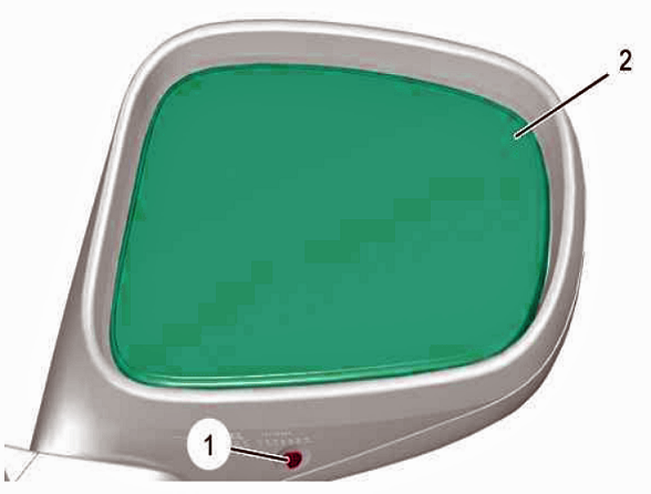

Re: 807 outside temp sensor

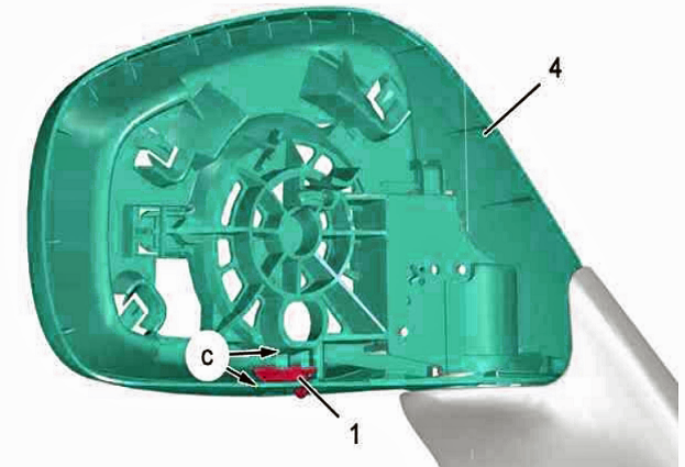

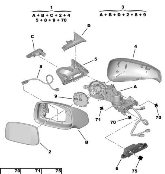

Ok, confirmed - it is number 8 in the diagram and should be on the underside towards the back - a little nipple.
If the temperature reading is not registering a reading then it has likely been removed at some point, but is a standard item. It is part number 6445F9 and these are still available from the dealer priced £47.09

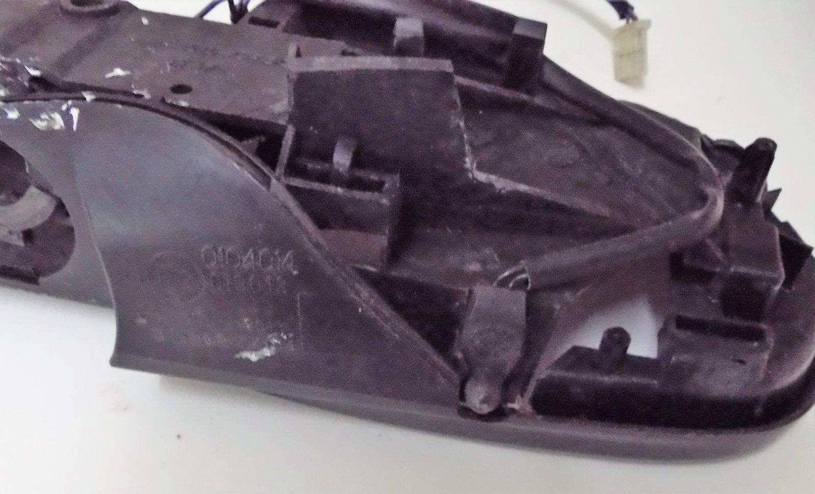

There's my recently shattered C5 mirror sitting on the bench here with the temp sensor still in it, if it's worthwhile doing I'll take it out and post it to you, no idea what they cost, or where you're located.

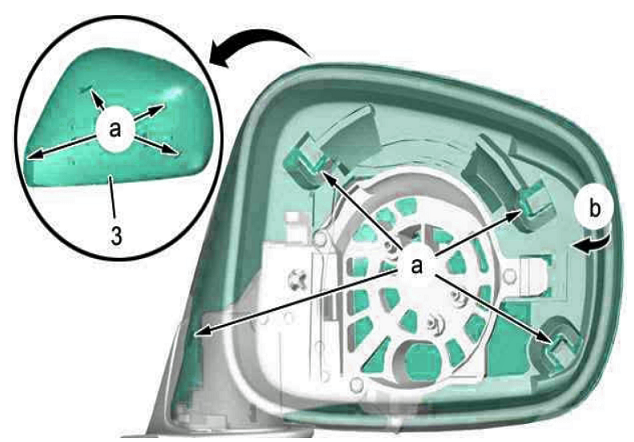

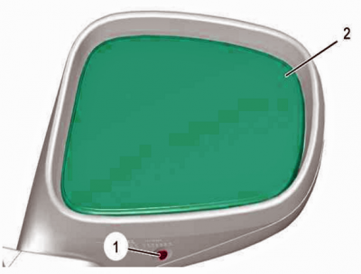

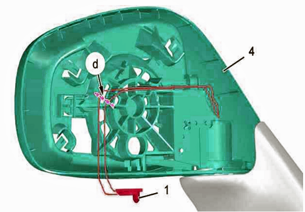

Here's the procedure, but I suspect that they have possibly, previously been cut from the source and not at the specified location...
Removing
Refitting
Restore the electrical connection of the outside temperature sensor (1) (at "d") ; Using the welding sleeves RAYCHEM.
Position the exterior temperature sensor (1) in its housing.
Refit:
The shell of the rear view mirror (3)
The glass (2) of the right-hand exterior rear view mirror
Reconnect the battery.
Check the operation of the sensor.
Check the electrical operation of the equipment.
Removing
| (1) Ambient temperature sensor on the right-hand exterior rear view mirror. Disconnect the battery. Remove the glass (2) of the right-hand exterior rear view mirror. | Detach the shell of the rear view mirror (3) (at "a") ; Using tool [1350-ZZ]. Tilt the mirror (In the direction of the arrow "b"). Remove the rear trim (3). |
| CAUTION : Detach the exterior temperature sensor (1) ; Using tool [1350-ZZ] (Against the frame (4) and the plate at "c". | Detach the harness of the sensor (1) from the frame (4). Cut the wires of the exterior temperature sensor (1) (at "d"). N.B. : "d" = 30 mm minimum from the sensor. Remove the external temperature sensor (1). |
Refit:
That's a RH mirror in your pics Marc, the C5 is in the LH and I think that's where the op was looking.
- x 6945
It's a Peugeot 807 Gibbo (which this thread is about - no mention of a C5 anywhere
) and that is the procedure - regardless of LHD / RHD - they don't duplicate procedures when it is the same regardless of Passenger or driver side.
Yes Marc I knew it was an 807 but guessed it would be very much like the C5.
Here's my shattered one.

So just to clarify:
- The 807 (all models) have the sensor
- On RHD vehicles the sensor is in the passenger side mirror
- On LHD vehicles it is in the right hand side mirror
- The procedure is the same regardless of LHD / RHD
- If it is missing, then it is likely the mirror has previously been replaced and the wire was cut and removed by the breaker (because it does not have a connector to unplug it)
- Either way it is standard equipment so was there when it left the factory
