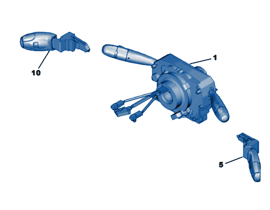

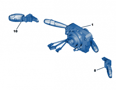

That looks well butchered!
The wires are for the Air bags and horn.
In the above, the Comms unit is item (1) and the optional Cruise control is item (10) and the optional Audio controls is item (5). Items (5) & (10) just slide and lock into the comms unit and if you have these on you old unit, should unclip, slide out and are designed to lock into the replacement unit.
The Comms Unit itself contains the wiper and indicator stalk and come as complete unit and are not intended for separation. Most of the units on ebay come with the wiring plugs attached, and these simply plug onto the airbag boss in the middle of the steering wheel. These are NOT designed to be lopped off and reattached! If that's what you've bought, I'd send it back.
I'm assuming you've ordered the correct part too - as these are not standard and must be correct - there are hundreds, so it must be the correct one.

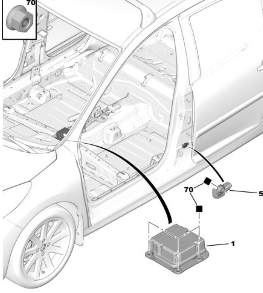

Absolutely. Before doing anything, flip the bonnet and disconnect the battery negative (don’t allow it to accidentally reconnect), and await for 10 minutes before doing anything with the airbag wiring. This is to allow the airbag capacitors to discharge ( risk of igniting).
But you shouldn’t need to do anything with the airbag ECU, as that is buried in the centre console somewhere near the front end of the dash. You just need to disconnect battery and wait, then when you get to the steering wheel boss airbag, you can note the colour connection and disconnect the plugs.
This is the Airbag ECU:

Check my post above , I added the airbag ECU control unit to show you where that Is!
