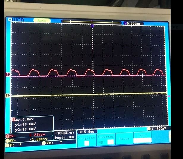

I was measuring pin#2 on white connector and there was no signal, when this short period of signal is omitted every 30s. On pin#1, I think thats the front electrovalve (less than 2 Volts, bit low?):

Main suspension EVs should be 12v for 0.5sec 3A (pull-in), followed by approx 3v 0.5A (hold-in). The latter is actually a PWM at 1kHz, which equates to about 3v mean.
d.c. resistance of the EV is stated as approx. 4.8 ohm.
An LED (with resistor) will show the correct operation of the EVs, at the two power levels.
Correctly installed and working diodes are essential to the EVs working properly, installed either at the EV end, or at the ECU connector. Even if the one at the EV is intact and working (and they can fail), it is worth installing a second one (at the ECU connector, for convenience) for protection of the ECUs output stage, and positive solenoid action. 3A 400v is a pretty safe diode spec.
Be careful with choosing suspension ECUs for Xantia. Activa ones may have been a single version, but standard Xantia ECUs were also shared with later XM, and need to be configured into Xantia (or XM) mode.

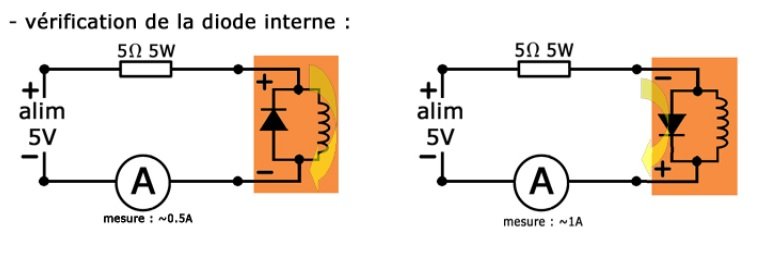

I was tipped to use resistor as in the pic to measure EV solenoid: (from 007 site)

That test would tell you whether the int diode was working or not.
Worth fitting additional ones, in any case.

white exec wrote: 16 Jan 2019, 06:39 That test would tell you whether the int diode was working or not.
Yes exactly. That should also tell if coil is burnt, I guess. If the current rises.
Antti
Xantia Activa V6 -98
DSuper5 -73
2CV4 -73
x 1751
Re: Activa V6 -98
With polarity one way round, both diode and coil should conduct.
With polarity the other way round, diode should not conduct, so current reading will be lower.
The 5? resistor is there to limit current through the diode in the conducting direction - and why 12v mustn't be applied direct to the EV.

xantia_v6 wrote: 16 Jan 2019, 10:49 You could use the oscilloscope to compare the waveforms on the front and rear VN05s, including the drive waveform and the current sense pin (I think that there is one).
This is something I already tried, nerve wrecking :-D since the signal comes on for a second every 30s and I could't attach the probe to signal leg of VN05N. On the other side tried not to short circuit anything :-D
I wonder what the proper input waveform should look like? Voltage? What's the "current sense pin"?
