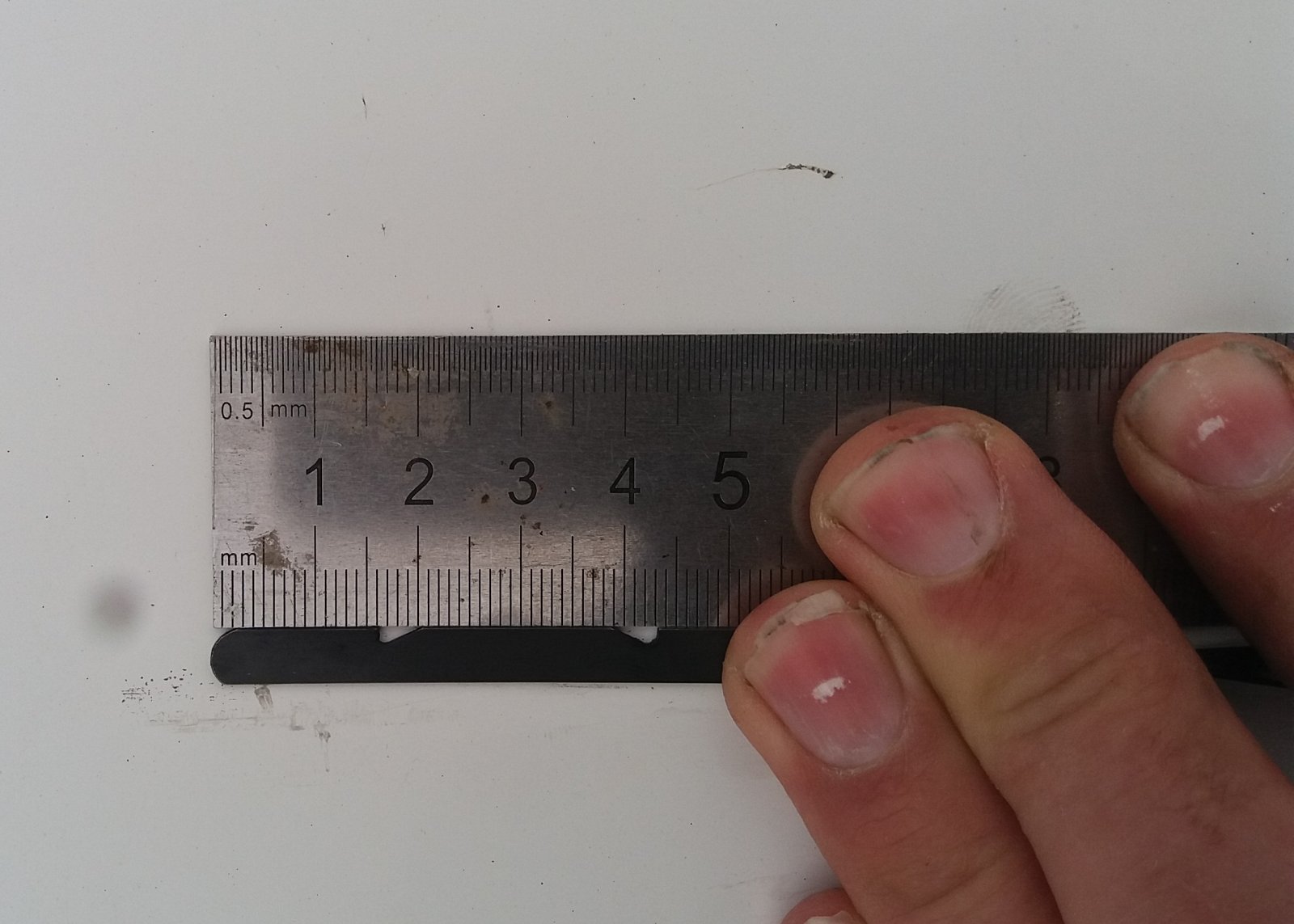

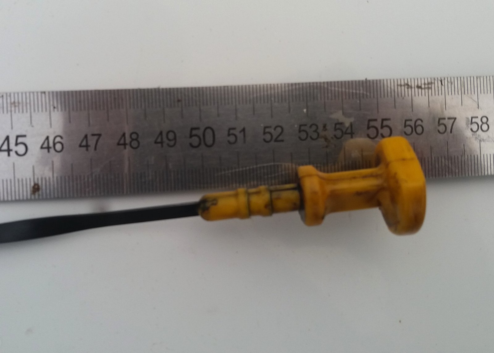

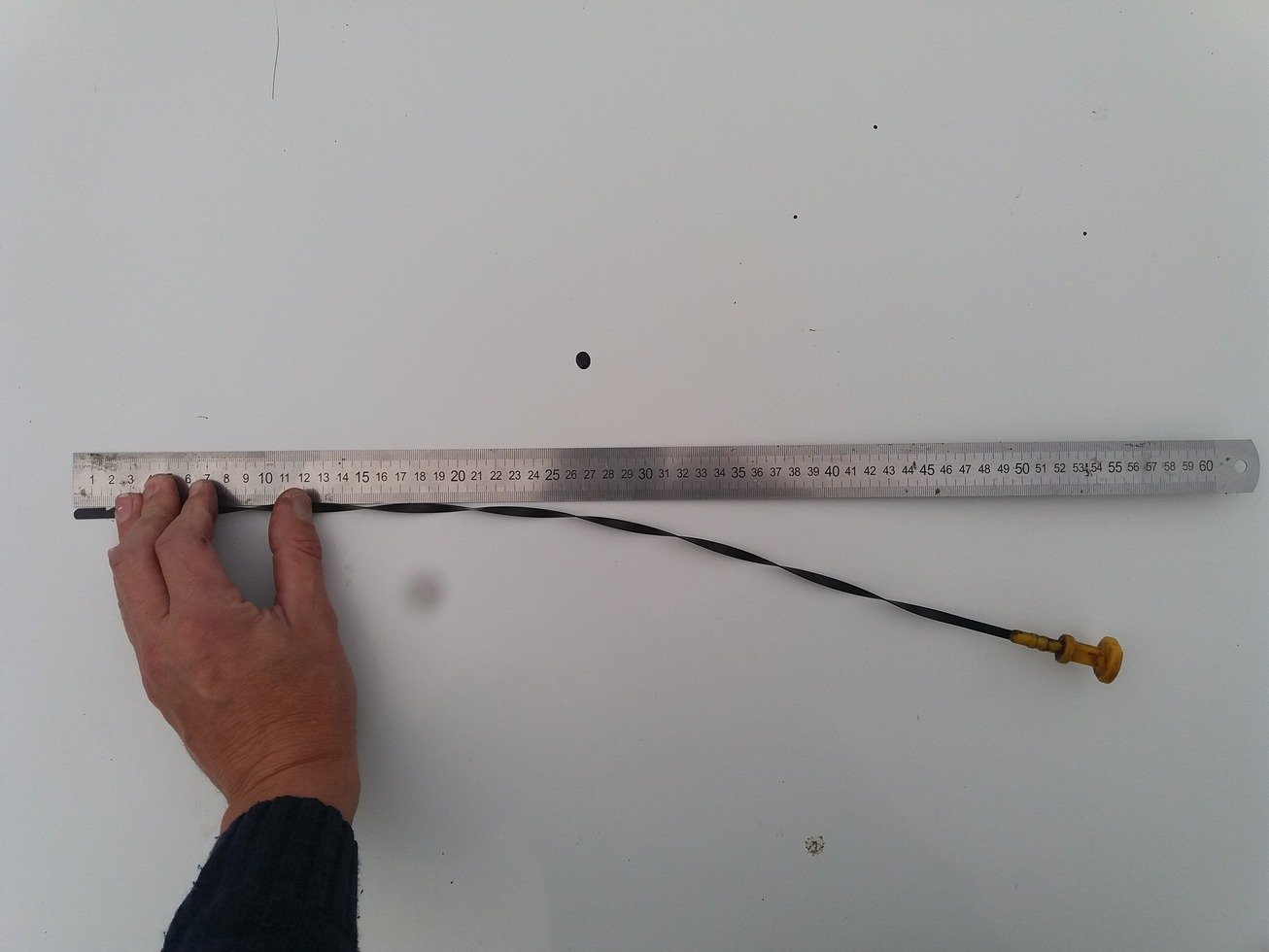

510mm as per the picture you posted is exactly what is quoted on both the ones for the XUD9TE with and without A/C. So looks ike you have the right one.

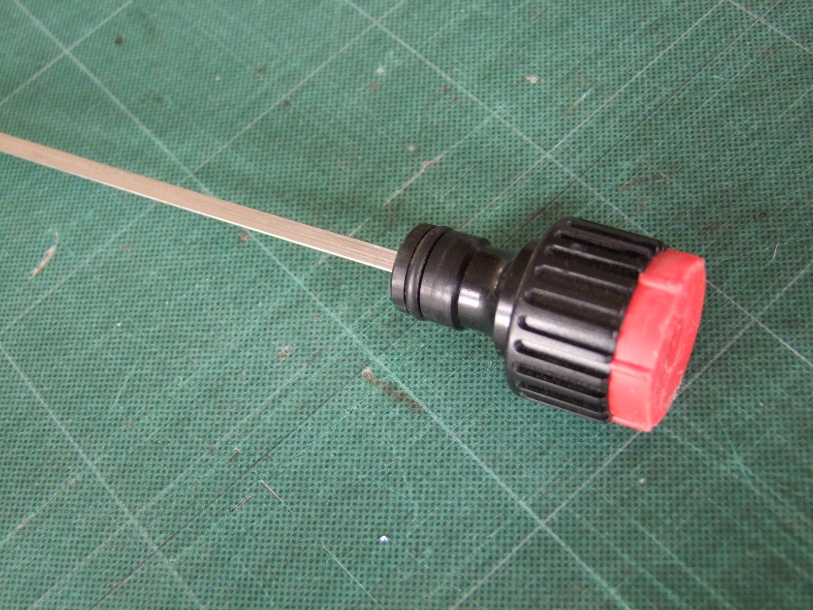

A dipstick-top repair, after the yellow top crumbled. You'll recognise the Hozelock/Gardena part, no doubt, with a ½"BSP blanking cap added...
The critical distance from tube top to High mark was preserved.

Now that is improvisation Chris
AS long as it does the job!

Ok, so from the VIN you have supplied - IGNORE my previous post (another reason why the VIN is so important), as that is a completely different part.
The dipstick for your 405 with that VIN is the same as I posted up for Sparksie, namely part number: 117415, same cost and length - so NOT 500 mm as in my last post which was for the earlier pre-restyled 405.
So for clarification, the correct one for your 405 is:
Part number: 117415
526 MM Length
£15.38 Inc. VAT from the dealer
The one in your original photos would be 26 mm too short.
