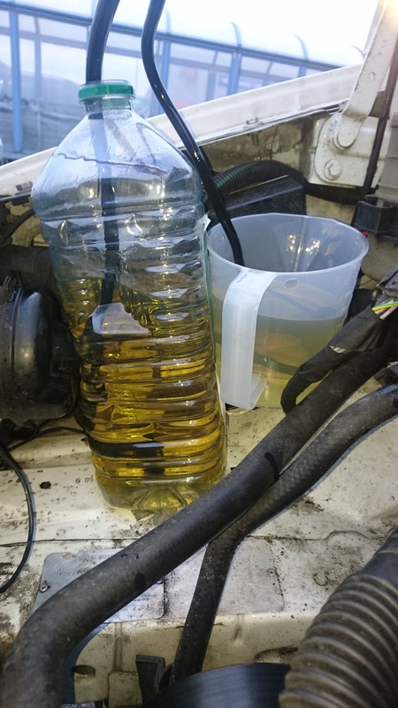

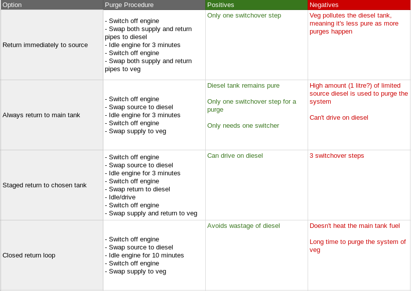

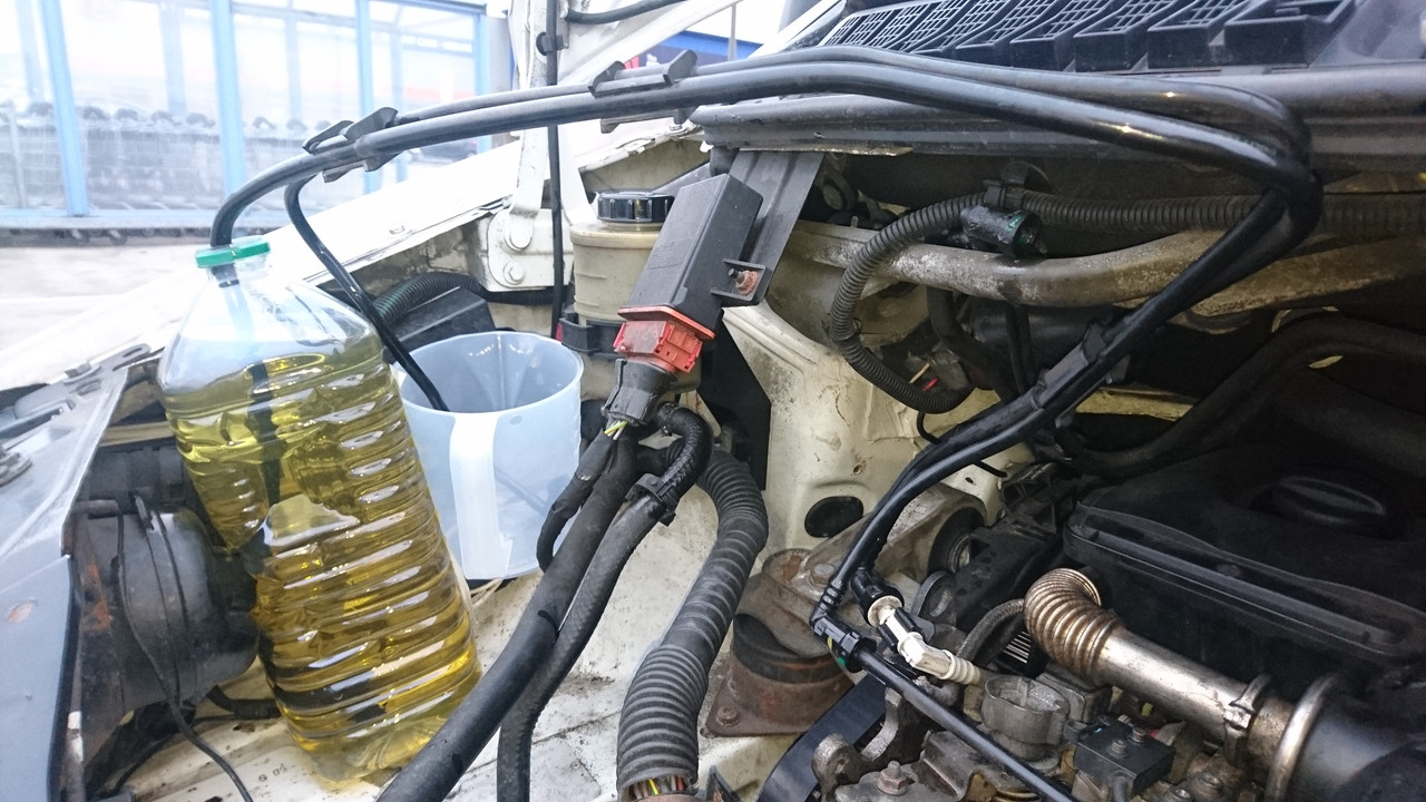

So I was toying with the idea of a bodged twin tank setup that I don't even need to fit into the engine bay. Just something that lets me purge the veg from the filter and pump so the cold start is on 100% Derv.
Did a bit of a proof of concept today and it seemed to go quite well.
I separated the return as I wanted to see what ratio is consumed vs returned. Turns out, a lot! ~800ml returned vs ~50ml consumed in 2 1/2 minutes of idling.
So I'll need to have a think about what to do with the return.
It's all a little fun to play with

Could you not run a twin tank system similar to that used on the old TVO tractors? They started on petrol, once warm switched to heating fuel, then before turning the engine off, switch back to petrol to cleanse the system ready for the next start.
Pete
- EDC5
- Posts: 1216
- Joined: 01 Jul 2017, 21:48
- Location: N. Wales
- My Cars: Citroen C5 RHR AM6
- x 120
Re: Had a play with a makeshift twin tank for the veg oil running in my DW8 1.9D Dispatch
Surely two 3 port solenoid valves could be used. One for the fuel line and one for the return line.
If you wanted to be clever, you could time the return 3 port valve to wait however long it takes to purge the return with diesel line before it switches over

Yea this is an option I'm considering, but the £80 in solenoid switchers is a bit hefty. I'd be happy with just a manual switch in the bonnet as I won't be using it every day.
