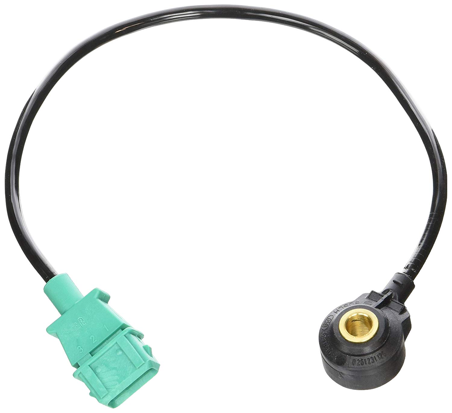

Hi everyone,
My brother owns a Peugeot 405 1.8i (XU7JP LFZ).
The knock sensor is faulty and should be replaced but I couldn't find the tightening torque in Haynes.
I know that following the exact torque number for knock sensor is important and has a significant effect on its performance.
Anyone here know the exact torque specs for the sensor? It is a Bosch type with green socket. Something like this:

I don't have access to the aforementioned data but it seems that tightening torque for the knock sensor is 20 nm. I searched a lot and found this number.
