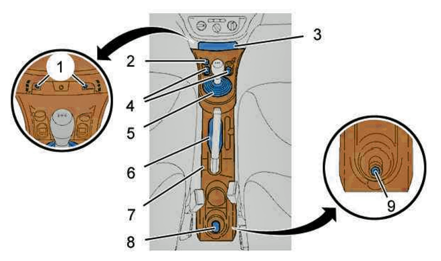

Is this an original?
The socket that the Cigar lighter or accessory goes into is accessed after removing the central console as in the diagram. There are 3 bolts, 2 under the cover (3) and one at the rear (9).
Remove:
Remove:
- The rear cover ( 8)
- The nut (9)
- The handbrake trim (6)
- The gear lever gaiter (5)
- The front cover (3)
- The bolts (1)
- The cigar lighter ( 2)
- The window winder buttons (4)
- Remove the central console (7).

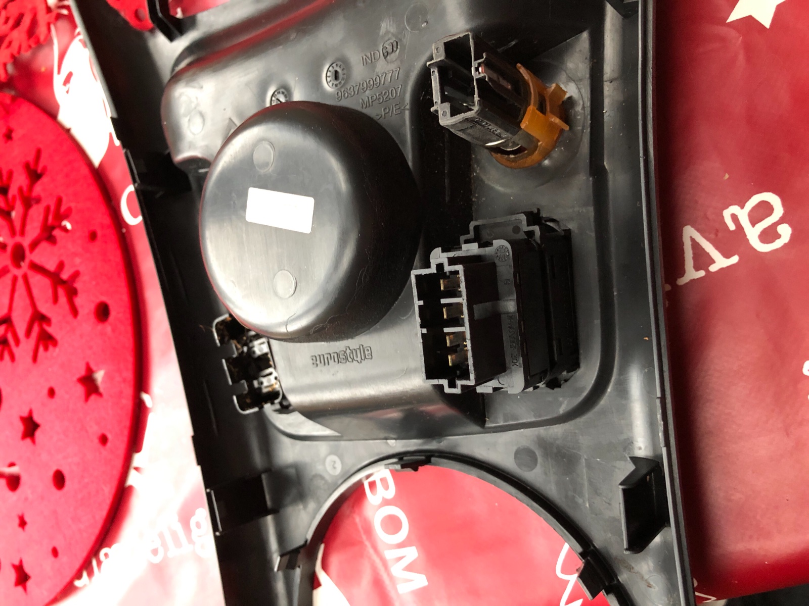

Well I’ve got this far but now I’m stuck!
- x 6945
Re: Removing 12v socket C2
What seems to be the problem?
If you bought a replacement, you just need to unclip the black plug from the amber lighting plastic and replace with the new parts.
I'm assuming you have bought a proper OEM replacement and not a generic one? You should have these parts:
