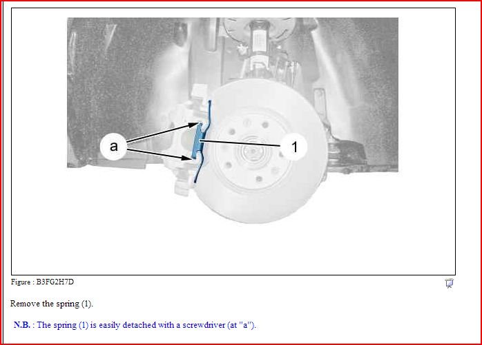

They look like this. Anyone know how to take them off and put them back on?

According to Citroen:
If it's anything like the ones on the MK1s, it will spring off with ease, but will be almost impossible to refit!!

I used water pump pliers squeezed the clip in a bit and used screwdriver at "a" to lift the clip out.
refitting - I used water pump pliers to squeeze it into place then I tapped the clip at "a" down into the hole with a hammer.
Very easy.
