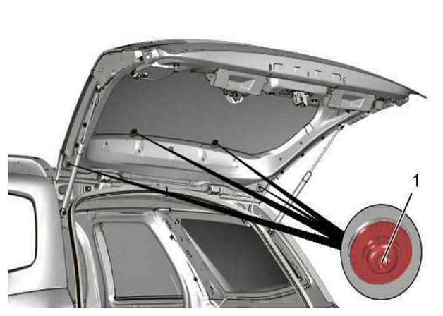

Ok, so here's the guide, and a note for others, this is for an X7 Tourer without motorised Tailgate.
Disconnect the battery.

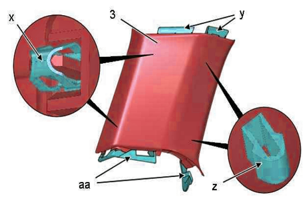

Unclip the rear pillar trim (3) (at "x","z") using a trim removal tool.
Detach: The rear pillar trim (3) ( as "y", "aa").
Remove the rear pillar trim (3).
Remove the bolts (1).

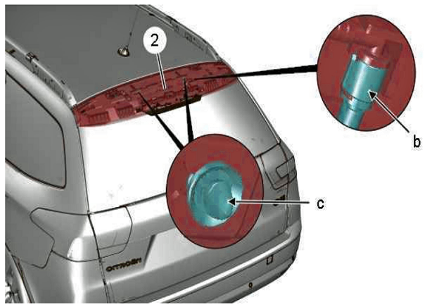

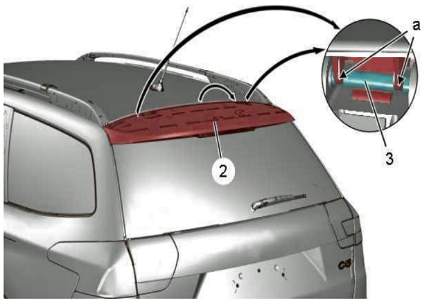

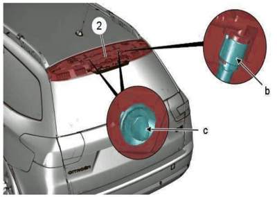

Unclip: Detach the hinge pin (3) at "a" (following the arrow ), using a trim removal tool.Unclip the clips ( as "c").
Uncouple: The wash-wipe pipe ( as "b").
Remove the tailgate spoiler (2).

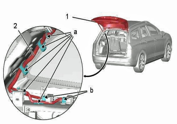

Open the flap (1).
Immobilise the lock.
Disconnect the connectors ( as "b") (According to equipment).

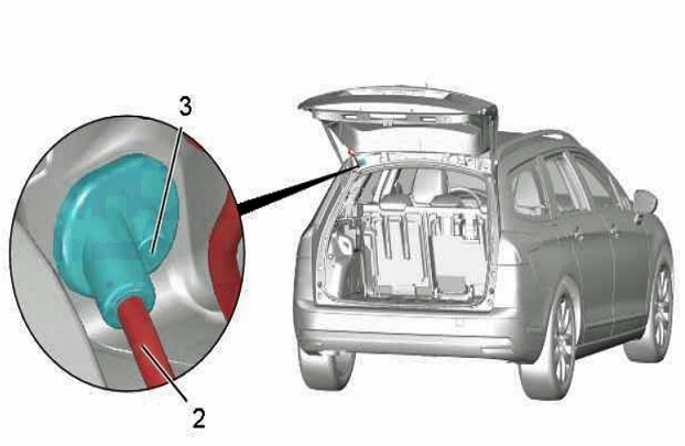

Unclip: The harness (2) ( as "a"), using a trim removal tool.
Unclip : The sleeve (3), using a trim removal tool.
Release the harness (2).

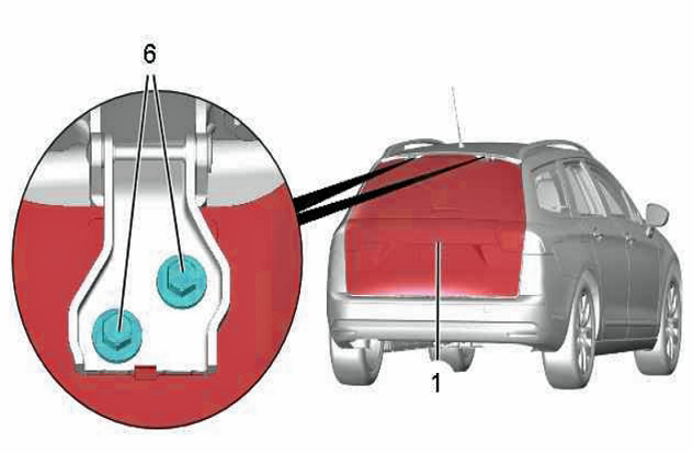

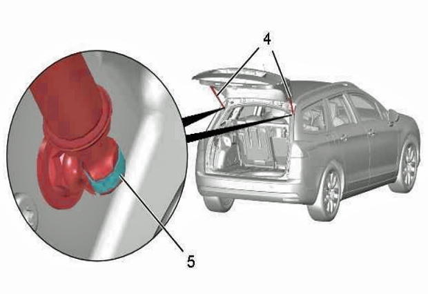

N.B.: Operation requiring two people.
Unclip the stabiliser (4) clips (5), using a small screwdriver.
Close the tailgate (1).
Remove:
  • The bolts (6)
  • The flap (1)

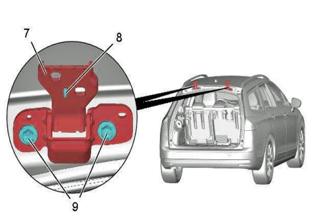

Adjustment
Pre-tighten the bolts (6).

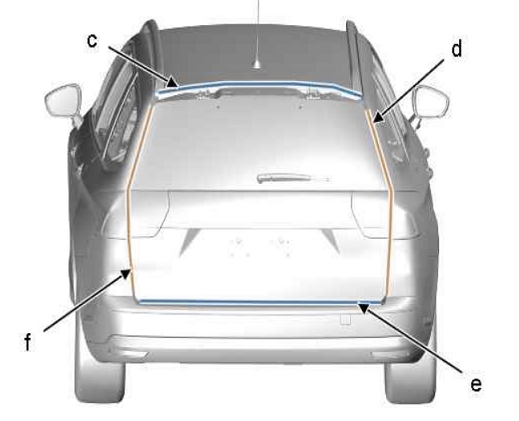

Adjust fits and clearances ( as "c", "d", "e", "f").
If necessary, the adjustment of the tailgate can be supplemented by adjustment of the tailgate hinges (7).
Drive out the indexing point (8), using a pin drift.
Adjust fits and clearances ( as "c", "d", "e", "f"), using the bolts (6), (9) and the tailgate stops.
Tighten the bolts (6),(9) to 1,5 ± 0,4 daN.m.
