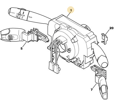

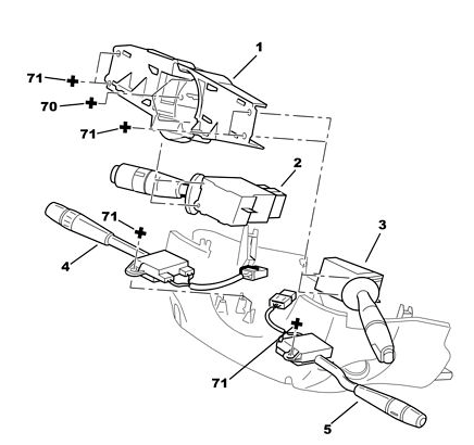

1) From your original post, you say your Comms unit was replaced. What we need to know is which of the 2 types of unit you have, as they are visually different. Look carefully at the stalk controls and especially at the end of the wiper stalk - there are distinct differences between the 2 units. You may or may not have the additional stalks for Cruise control and the audio controls, but if you do this will make it easier to identify. But what is important first of all, is that the replacement Comms unit must be the same as the original one. Can you confirm that the replacement had identical stalks to the original, and which of the 2, 'A' or 'B' below do or did you have?
2) Does your 406 have ESP? I don't mean just ABS, but ESP too? If it does, there should be a button somewhere on the fascia or console that says ESP like this:
3) Do you have a Rear Screen Wash / Wiper?
If you can answer me these questions precisely, it may help me narrow down the choices of the 8 Comms Units.
'A' With Multiplexing 'B' Without Multiplexing 406 With Multiplexing.PNG 406 No Multiplexing.PNG0

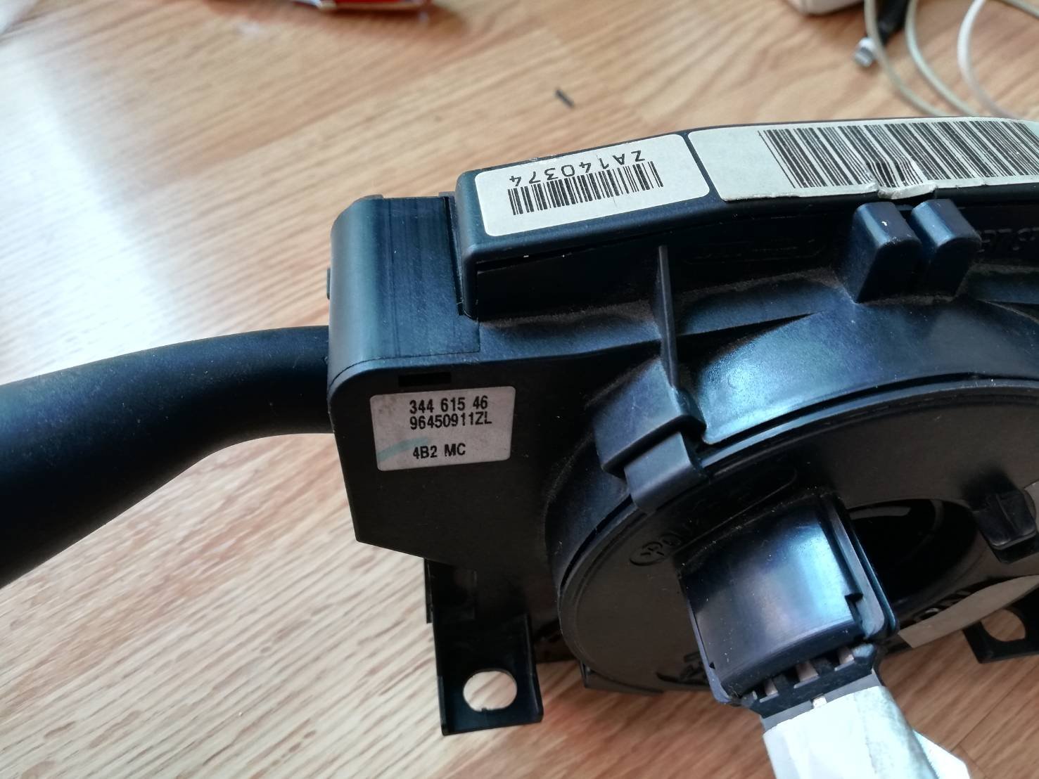

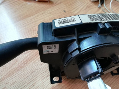

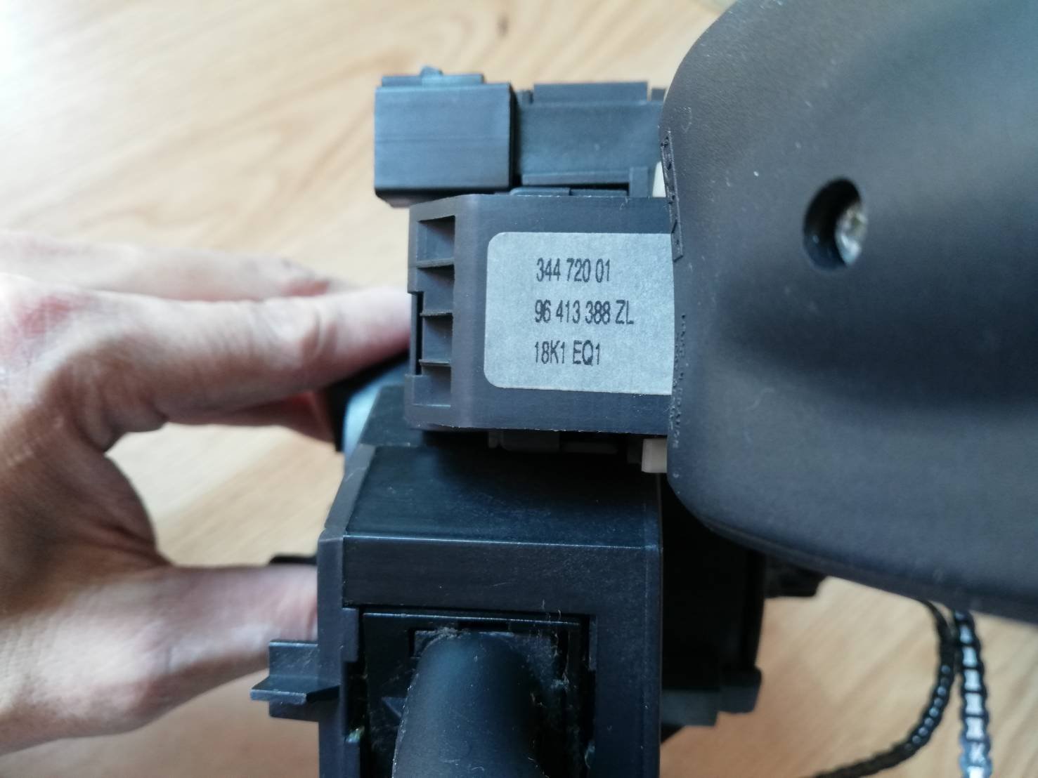

Re: 406 D9 : replacement of com2000 + mainlight sign flashing
Happy new year 2019 Marc,
Here are some codes at the original Com 2000.
Toh
Toh
