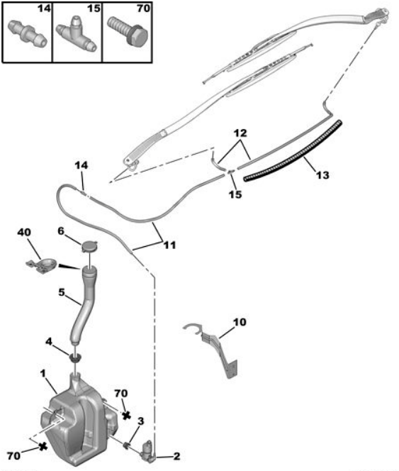

The lower part of the washer pipe is number 11 below and is part 643947 and is 4mm x 8mm.

Thanks for the diagram, but I'm not sure what you mean by 4mm x 8mm? Does it start at 8mm and reduce to 4mm? Is part #14 a reducer?

I think that the 4mm x 8mm is the inside x outside diameter of the pipe, and i believe part #14 is just a joiner, as is #15 which appears more to be a T piece allowing the pipe to be split into 2 directions.

Just re read and looked at the diagram, i think the pipe has come away from the pump itself or split between it and #14. Believe you can get joiners like #14 to repair a split pipe rather than replace the whole bit

Yes those are unions - one a T piece and one a simple join. Correct about the sizing 4 x 8 is what the tubes are.
