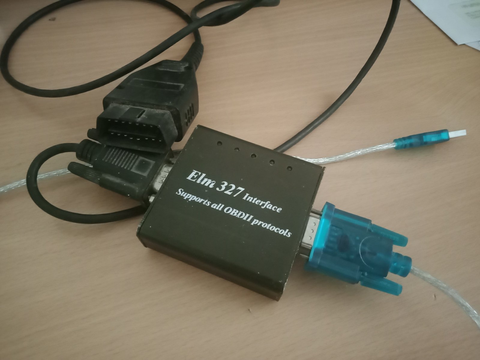

Hi i have searched all over the internet and cant find anything on this i think its very odd.
I have a 3002 Citroen c5 turbo diesel and is stuck in limp mode (seems like the turbo isnt working)
I have an elm 327 to read the codes a usb one so i hooked it all up and it read the code from the car but i went to start the car and put the battery charger on the
battery and 2 lights on the eml327 box come on (communication lights) and it fried my usb cable and now the cable dont work (cable is a serial to usb from ebay).
Just wondering if anyone would know why putting the charger on the car would send power through the data lines and fry the cable to the point it was hot.
I didnt have enuff time to save all the code to show what the codes where but there was 19 codes.
I attached a pic of the elm327(odb2)

It was probably a ground-loop through your PC back to the mains. That diagnosis is making some assumptions about your charger and PC. I don't think that it was likely caused by anything on the car itself, but it could have caused collateral damage to the electronics on the car. I hope not.

And its only when i hook the charger to the car the light come on on the elm327 box then fried the usb cable i just cant see how boosting the battery would change anything to do with the odb2 port

On frying your Elm, it is never good practice to try to start a car whilst a battery charger is connected.(battery boost packs are different as they can kick out 400 amps plus and work differently) as, if the battery neutral has a poor connection the starting current will take the least line of resistance to earth (through the charger or in your case, through your Elm). See the running forum post on “Check your earth leads”
