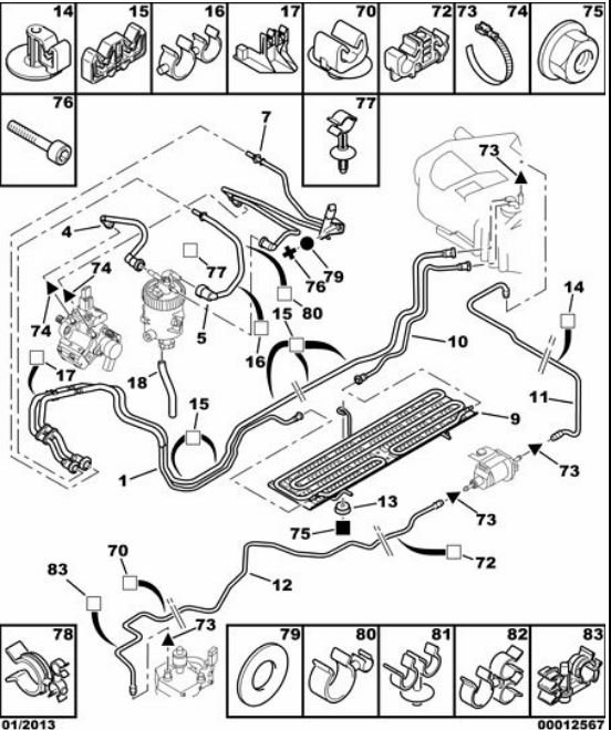

A recent post threw up that this vehicle
C5 5 DOOR SALOON 2.0 HDi 110 (DW10ATED)
was fitted with a diesel fuel cooler - #9 in the diagram...
I'm used to the idea of diesel fuel needing warming in cold conditions, but the requirement for cooling was something I just hadn't realised.
