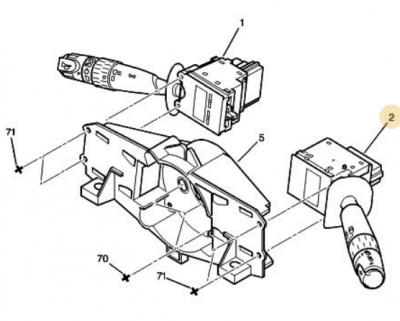

Rich - if he's having issues with the wiper stalk - then these modules are plug and play - and can be inserted as a new unit into the Comms control unit without having to replace the whole unit.
The part number is 623961: it is item 2 on the diagram:
They are made by Valeo and there is one here on the bay of evil for £80 brand new. Citroen charge £145.93, so a considerable saving. They don't need coding, but I would think twice about putting in a used one - as you have no idea if and when this will fail as many do at some point.
