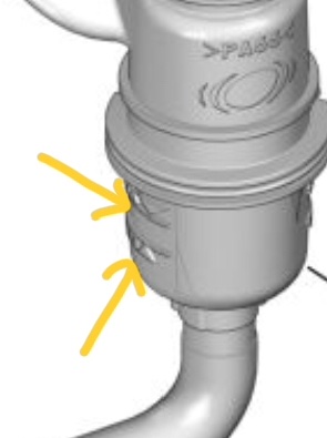

He’s on springs Robin.
Look on the power steering reservoir left hand side of engine, the markings on the container should show max and min arrows as I have marked in yellow.
Top up only to the max level.
Edit: correction, the OP has the DV6TED4 engine and metallic suspension, so has a coupled pump instead of an electro pump and the correct tank is shown in my next post in Green

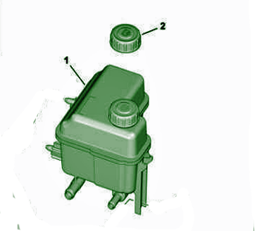

My mistake - you have the DV6TED4 engine and metallic suspension, so that means you have a coupled pump and a slightly different tank:
So this is the tank that contains the power steering fluid, which should be a black tank. Standing in front of the bonnet looking towards the windscreen, it should be on your left near the front corner.
