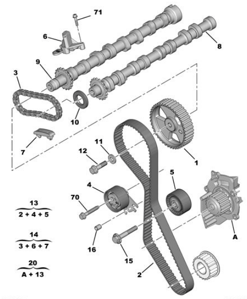

Approaching 140k without any issues (except replacing the steering rack at 80k miles under warranty thankfully) and it's time for a good service.
Seen complete timing belt kits with water pump incl going for £70 but want to make sure it's the right part.
Engine is DW10BTED4 and VIN VF7**************[VIN obfuscated, can be read by forum staff]
This is https://www.amazon.co.uk/febi-bilstein- ... g+belt+kit example
Timing belt, pump and EGR valve

There are several kits for your engine - so depends what you want. Of course these are the Citroen official kit parts and prices:
0831T5: Includes Timing Tension Roller (4), plus Retractor Roller (5) & the Belt (2) £142.36
1609525480: Contains the same as the 0831T5 kit above, plus the cooling pump (A) and gasket £164.39
I'm assuming you have an aftermarket kit there - as it is too cheap to be the genuine parts. I paid £158 from Citroen for mine (DW10BTED4) for the works, as I wanted original parts for this job.
