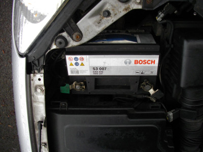

I Bought a Bosch S5 last December, no problems, as expected, made up list price was £169.52, got it for £93.49 from ECP. Car is 2.0 Auto
Amp Hours (Ah): 77Ah
Cold Cranking Amp (CCA): 780cca
Original was a Varta
Amp Hours (Ah): 75Ah
Cold Cranking Amp (CCA): 800a
