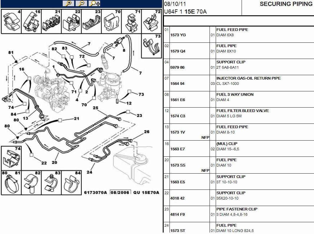

So you are saying that there is only the high pressure injection pump fetching the diesel up from the tank, ie. no separate lift pump. That would explain why I can't find one. If the whole system up to the pump is in "suction" then as you say, I should be looking to confirm all joints in the fuel line are air tight. If the fuel is not being pushed from the tank to the filter I would like to think there was a non-return valve somewhere to stop fuel just siphoning back in the event of an air leak at the engine but this isn't a perfect world.

Re: Expert anyone?
Here’s the system in your vehicle:
Click to Zoom
Click to Zoom
- x 1750
Re: Expert anyone?
One-way valves are often built into the filter units - certainly were in the earlier Purflux filters for the 1.9D.
