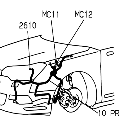

I would give the engine fusebox a good check over - make sure there is not water ingress that has caused any crud to build up. Double check your headlight bulb and these should always be replaced in pairs. Check the earth (MC11) as shown in the diagram below, as this one supplies the left hand light unit.
