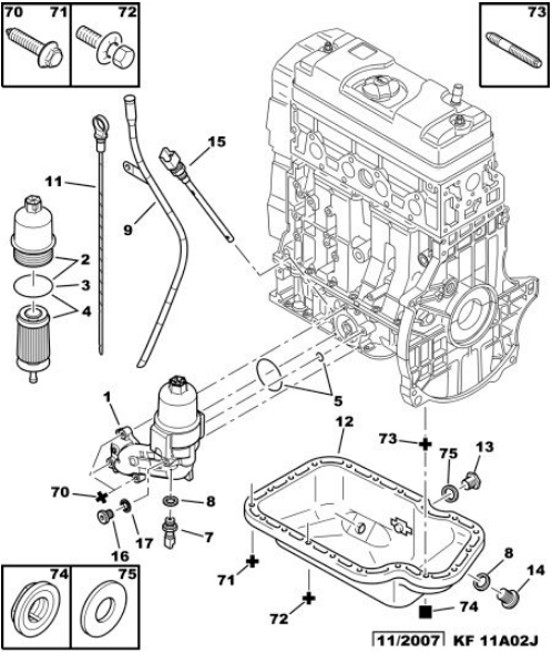

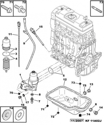

Here's the parts diagram - it shows the dipstick (11) and the oil gauge guide (9). Item (15) is the oil level probe that provides the electronic measurement for the dashboard.
As far as the oil goes, your 206 which has the TU3JP engine is one of those that can be drained through suction. The oil tube guide widens at the sump end to allow the connection of the suction draining equipment. There are various diameters, but yours is 14mm, so needs this adaptor. I'm guessing that the part that is broken off will be almost impossible to be sucked up the tube if it is already stuck where it is.
However, looking at the diagram, there doesn't seem to be a separate part for anything to snap off of the dipstick - so I'm wondering if this has been a replacement dipstick?
I'd let the garage see if they can fish it out, but if it does go back down it should be trapped by the oil gauze trap. Obviously you need to be able to get the part free from blocking the tube or you won't be able to get another dipstick in there.

The replacement dipstick tube is £20 so I thought I might as well swap it myself if DIYable. The top fixing is a bolt, not sure about the bottom. Does it just pull out/push in? Possibley have to remove manifold too? I wonder if the tube oil seal is part of the tube or seperate - Peuguot parts wern't clear about this. Nothing in my Haynes manual either.
Thanks for the diagram Marc - Alex.

I can’t see any reference to screws or other fixings, so have to assume it just slides in Alex. If there were a fixing of some sort, it should show up on parts.
The tube guide is part 1171H1 and priced at £22.08 inc. VAT
