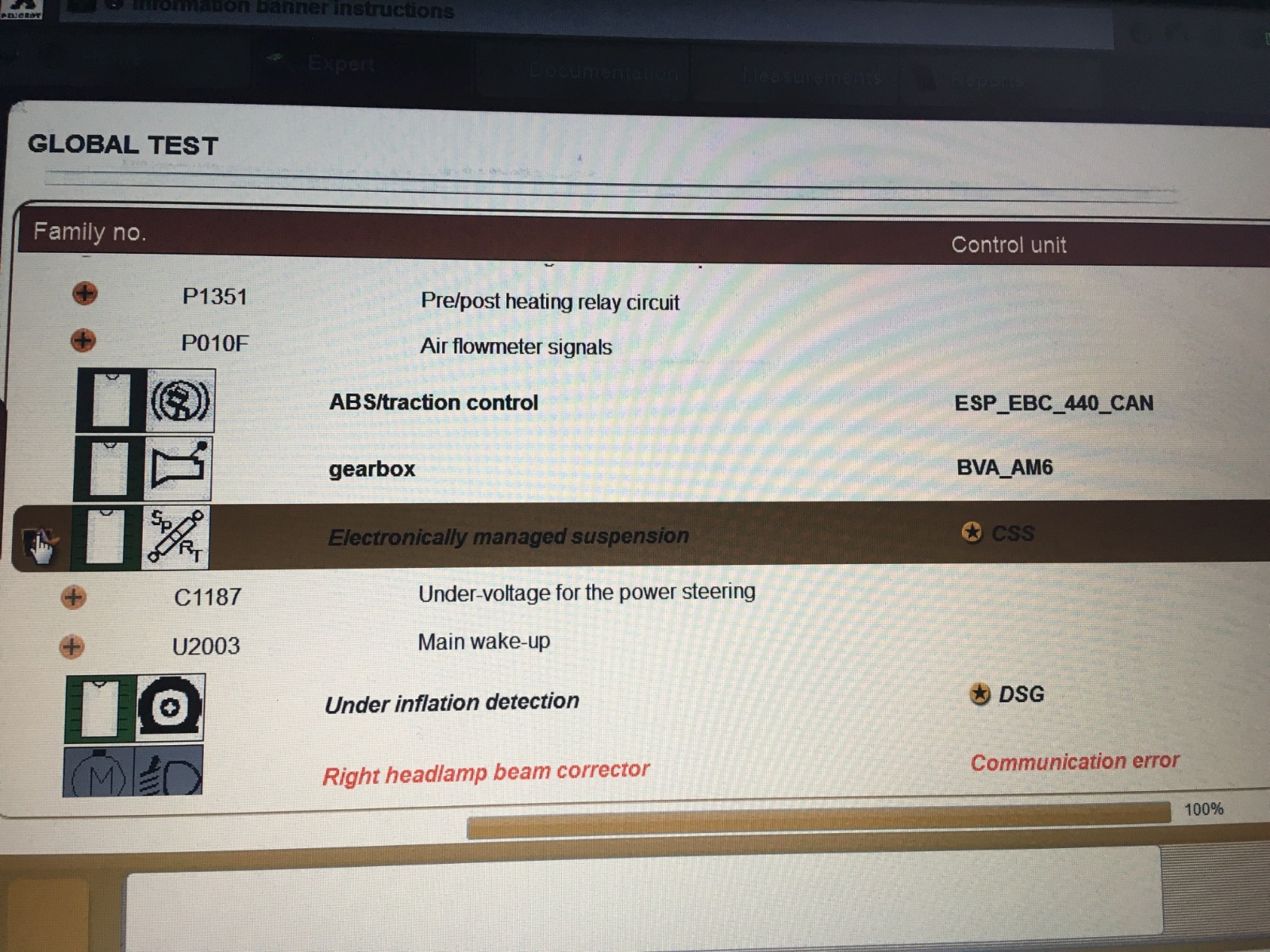

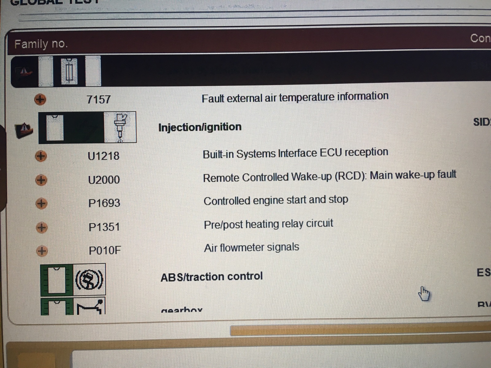

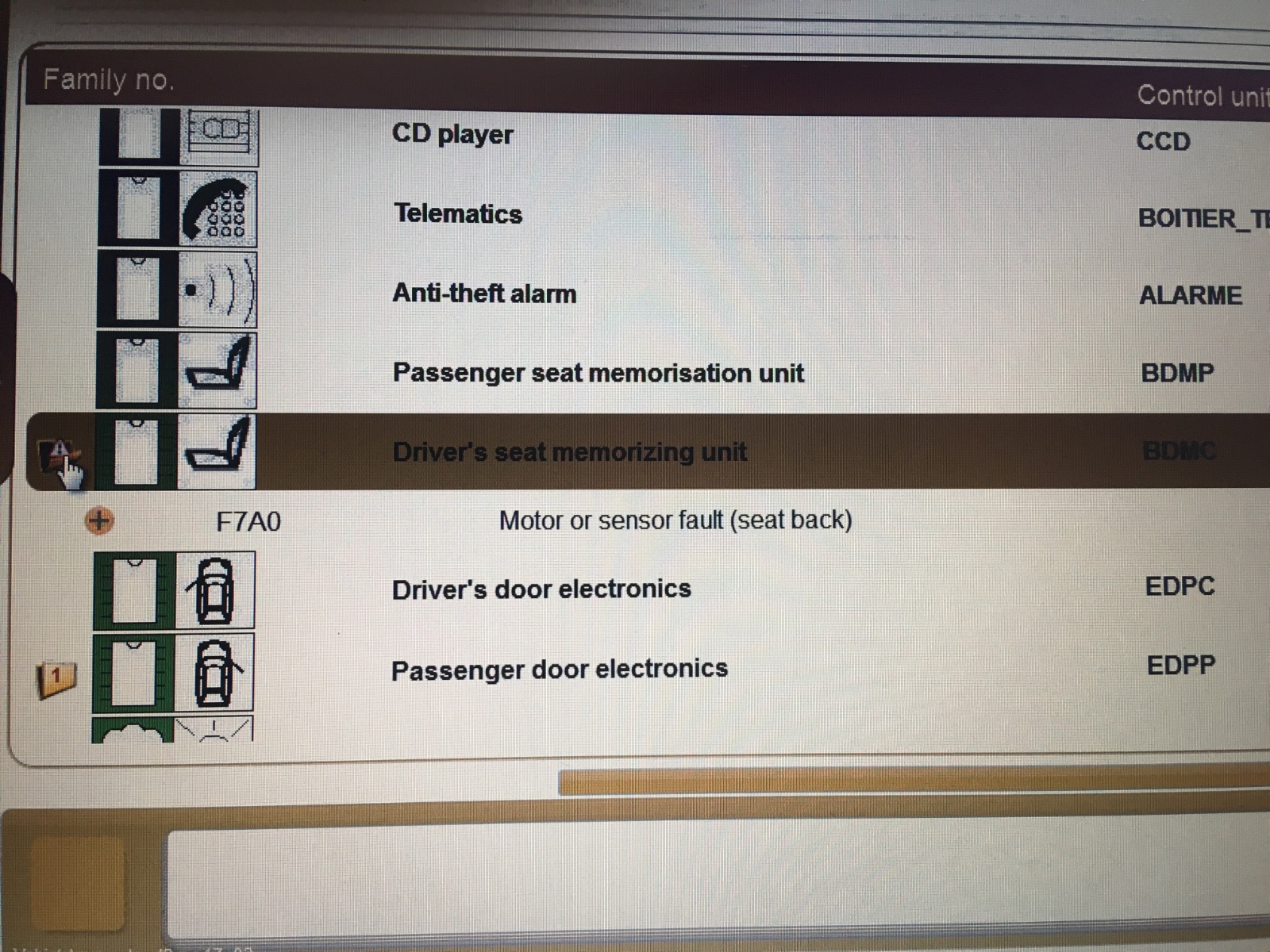

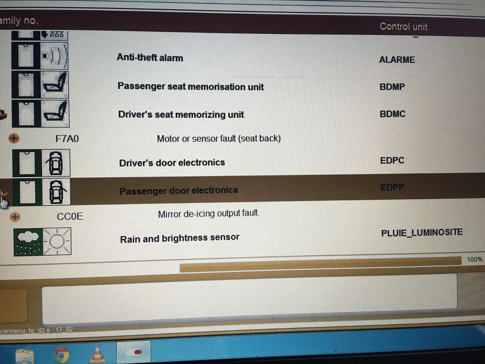

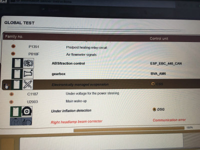

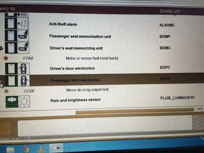

could anyone look at my diagnostic results from yesterday and tell me what to do to get the car working again please

Re: Fault codes on my 407 coupe
2 things
1) - Your VIN for this vehicle
2) Did you clear all the faults after running the Global test and then re-run the test?
This should just leave the current ones

The ones I got last time are the p1963 and p1531. I can’t get the vin right now as I’m at work

If the reg helps it’s *******. I didn’t cleAr the codes yesterday but the two I said were left after I did last time. I am assuming the rest are as a result of it sleeping for months.
Ok, I'll have a look at those 2 for you -
Unfortunately no further detail for the 407 with the Siemens ECU
P1351 Fault on the pre-postheating relay circuit: Relay controlled / plugs not controlled.
P1693 Start and stop piloting fault: Not characterised
If you expand the fault codes it might give you a little more info.
