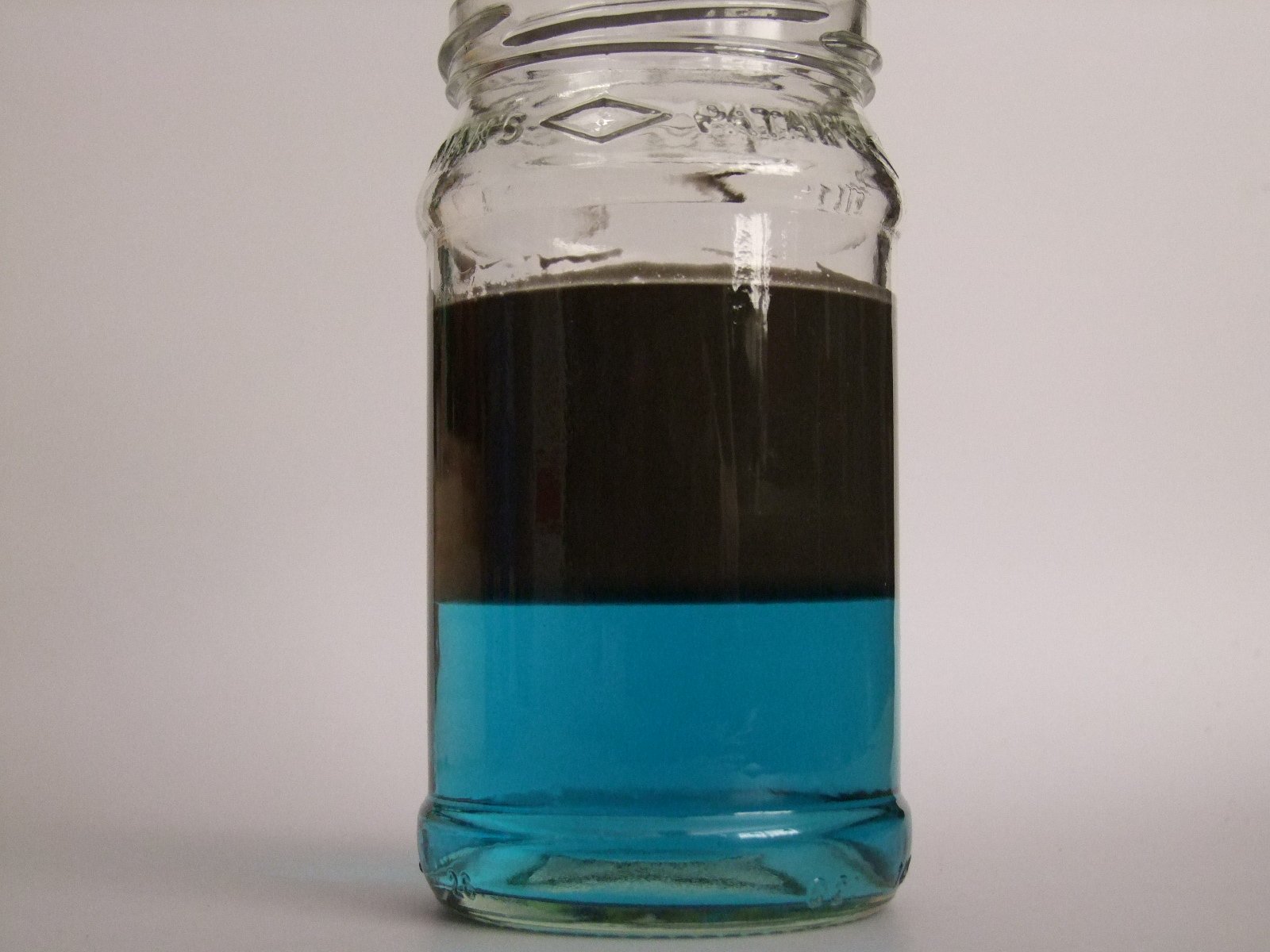

There are actually no universal standards for the colour of coolant, with manufacturer's free to colour their products as they wish. Generally, blue-green is standard glycol type, and red-pink-yellow is OAT (organic acid) type, but there is no certainty in this.
As said, OAT and glycol types must NOT be mixed, as crystallisation, goo-formation, sediment and blocking can occur. If in doubt, completely DRAIN the system, and refill with an approved type, placing a suitable label on the engine.
Do not mix makes or types, even if they are the same colour. You may get away with it, but you could be very unlucky...

The warning about mixing types comes not just from manufacturers, but also from a good number of trade and forum sources. Can also speak from personal experience. The grey stuff above floated on water, was not soluble in it, and had the consistency of marmite; you don't get nastier than that.EDC5 wrote: 10 Nov 2018, 11:33 I think it's very east to overthink these things, especially when manufacturers claim dire consequences from deviating from their own specification.

white exec wrote: 10 Nov 2018, 11:41The warning about mixing types comes not just from manufacturers, but also from a good number of trade and forum sources. Can also speak from personal experience. The grey stuff above floated on water, was not soluble in it, and had the consistency of marmite; you don't get nastier than that.EDC5 wrote: 10 Nov 2018, 11:33 I think it's very east to overthink these things, especially when manufacturers claim dire consequences from deviating from their own specification.
Very true, I was only talking about antifreezes in general. Obviously topping up requires the correct stuff but with a flushed clean system I don't see the necessity of using the specific antifreeze; especially considering that the same engine used in different makes can be specced with a completely different antifreeze.
