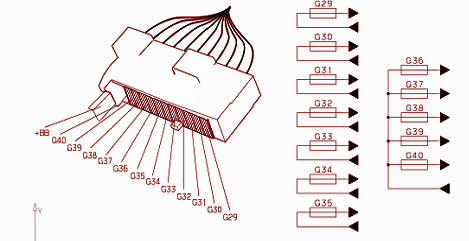

Ok, so here you go, all these are battery positive - obviously you won't have some equipment like the motorised tailgate or trailer unit fuse (if not fitted) and some of the other options. So you should be fine if you use a piggy back fuse connector. I would strongly recommend using a connection to the fuse box using one of these adapters in my dash cam post rather than taking a feed directly from a wire post-fuse box for 2 reasons. 1) There is less risk of interfering or splicing into a control or CAN wire and causing unrelated electrical problems with other equipment, and secondly, some equipment has a control wire that the BSI uses to switch the equipment power on or off according to timings or battery charge state.
Here is the particular fuse holder where these are contained. It is above the BSI fuses - which can be seen if you shine a torch up - see my photos in my post.
