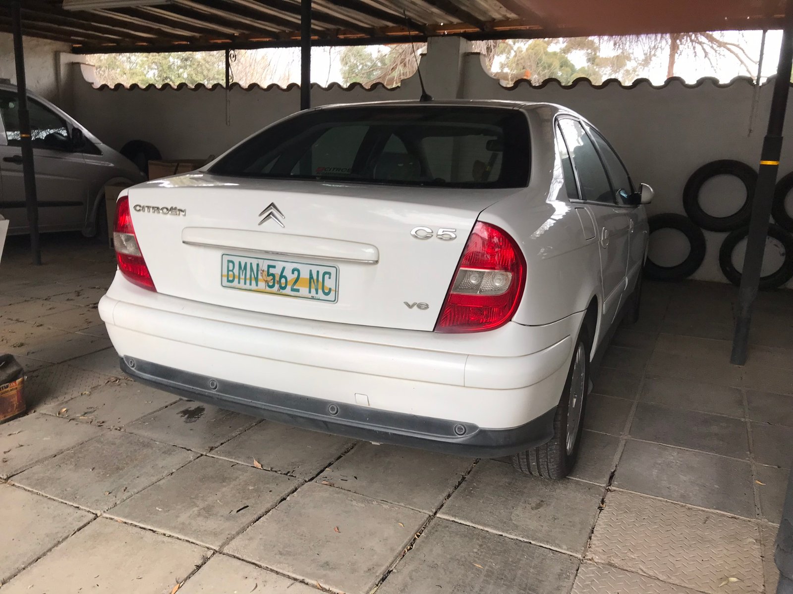

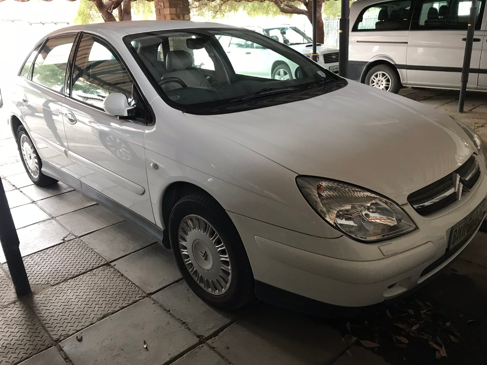

I am new to the C5 crowd but not to Citroen as I own a bunch of them, guess one is never enough.... My recent acquisition is a MK1 2001 54000mile 3.0 v6 auto Exclusive. Has a full service history and actually very carefully used. She has a few scuff marks here and there but nothing out of the ordinary.
Just wanted to say hi and show my C5.

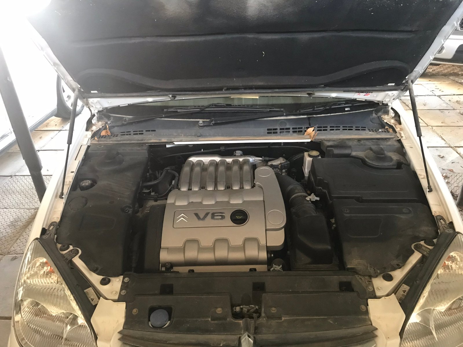

My pedantic cleaning created an issue for me.... I was a bit daring and took off the intake manifold and blocked the intake holes and covered it with vinyl masking tape. I then cleaned the top of the engine and well the while left side of engine bay to keep water away from the electrical box and battery. I left the car for a day to dry without starting and dried out the sparkplug holes. Proceeded to start the car and all seemed normal. After about 10 minutes a faint missing commenced. I thought well most likely bit of moisture in sparkplug holes. I took her for a drive to get to temperature, as I reversed the car started to miss alot and the engine light started to flash and the service light came on. The central display logged an "anti Pollution fault" I continued to drive her and the misfire stopped but the light is still on and the fault still logged. Drove her today, not skipped a beat, but engine light aswell as service light is on. and the logged fault still shows. I don't have a working lexia cable... Tried the battery disconnected route but light still on. guess I have to get a working cable now because to ask what could be wrong most likely is a silly question. From what I read it could be a coilpack or an exhaust temperature sensor?

Hi Corne (?). Yes, that's about the long and short of it - getting a Lexia cable really is the next step or repair your existing one - sometimes the pins in the plug can become de-soldered or loose - a little inspection there may pay off. The cables are widely available and cheap enough, but is essential really to get an accurate code and narrow the areas for the fault.
Also, retrace your steps to see if there is anything you didn't connect back up or a hose not secured or that has popped off - often this will be a likely cause of a fault that has recently occurred after some work in the engine bay.

You may find that the fault warning will clear itself after the engine has been run a few more times, assuming that the fault was temporary.

Hi guys. Received my psa-com unit. Quick install and it actuallt worked!!
Had a multiple misfire code and misfire Cyl 6. Cleared the code and the engine light on dash went off. So glad it is sorted. All back to normal.
