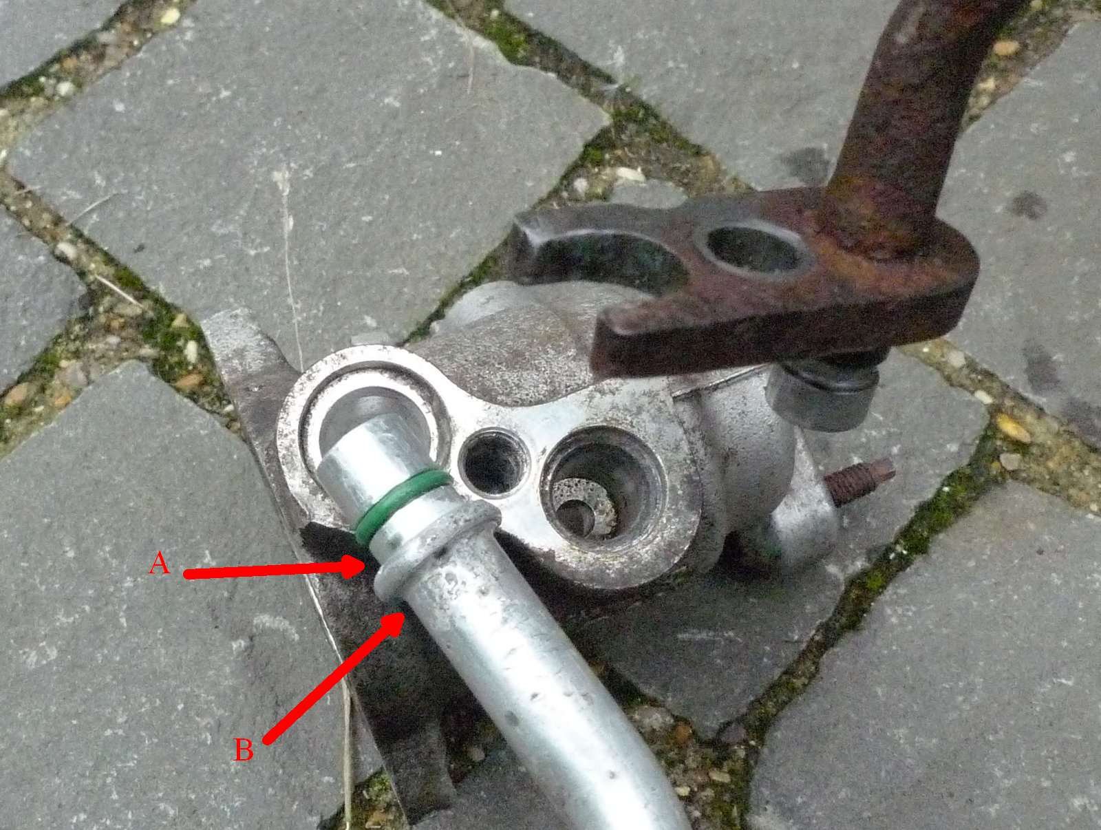

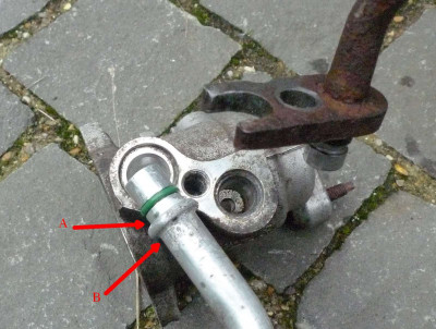

Well I have a leak from the LP pipe going into/out of pinion, Can anyone tell me which seal size I fit ?
I'm going to replace both seals as I had used the old seals when changing the rack in the spring was moving house misplaced my seals and required the car urgently. Managed to get 6 months out of them.

The genuine article ones that fit are 7.6mm x 1.8mm and 8.7mm x 1.8mm, so a very rough approximation of those will work, but make sure you use LDS resilient 'O' rings. However.... the conclusion that I came to - having had to deal with this problem - was that the 'O' ring seals were only part of the problem. I reckoned that the main problem was that the LP pipe was not far off 'one time fit only'.
For explanantion, have a look at my two posts here:
viewtopic.php?f=3&t=61066&p=587865#p587884

I bought the Peugeot ones linked to in my post here Kenny:
viewtopic.php?f=3&t=60155&p=576184&hili ... ot#p575859
Although the listing has ended the listing shows the seal part numbers, so you may find another listing - or there is another link where you can but them from in that thread on an individual basis.

The genuine seals are still available from LCS Louth via eBay https://www.ebay.co.uk/itm/PEUGEOT-CITR ... 3303587562
but I'd caution against fitting them and hoping the problem's cured. I tried various sizes of 'O' rings - including the genuine ones and oversize ones - and none of them worked for very long. I'm convinced the problem was down to the worn out 'flange' embossed into the aluminium LP pipe. The steel HP pipe was fine.
'Wheeler' has been waiting ages for a new pipe from Citroen, so if you need a new pipe it might be worth investigating companies that can fabricate new aluminium LP power steering pipes. There's a break in the pipe around the area of the front corner (passenger side) just ahead of the roadwheel where a new pipe can be easily joined into the flexi pipe wiith a simple compression joint - so you actually only need half of the complete run of LP pipe.

Thanks Marc and Bobbins for the replies,
I'm tempted to glue the joint with something like JW weldglue, I've used this on various knackered threads and other items with great success. This would be a last resort if the seals fail to work.

I scratched various parts of my anatomy trying to come up with a solution that would work, but in the end opted to fit the nearly new spare LP pipe I had sitting in my shed.
The two options I was playing with was either to fit a ~0.5mm LDS proof ring seal around the pipe at point 'A' where the flange sits on its seat, or to use a ~0.5mm packing piece at point 'B' to enanble the flange to press fully home into its seat. Any more than 0.5mm would probably throw out the how the steel HP pipe seats in its recess.

The design of the joint looks as of it is intended that the ali tube is held rigidly in its circular groove, leaving just the green O-ring to achieve a fluid seal. A problem with fitting additional O-rings on the underside of the collar/ridge is that the pipe could then flex in the casting, and cause the green O-ring to eventually leak.
Might be worth checking the smoothness of the bore, and then fitting a new tight-fit (Viton) ring to replace the green one, lubricating it as it is fitted. I think the pipe must be clamped solid: use an opened-up or two halves of a washer or similar on the topside if necessary, to provide extra packing, and the same on the other pipe to equalize the arrangement, if that thick plate is movable.

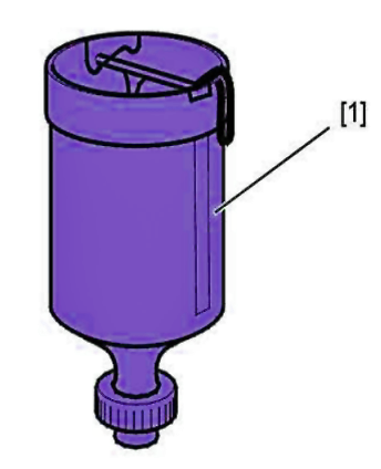

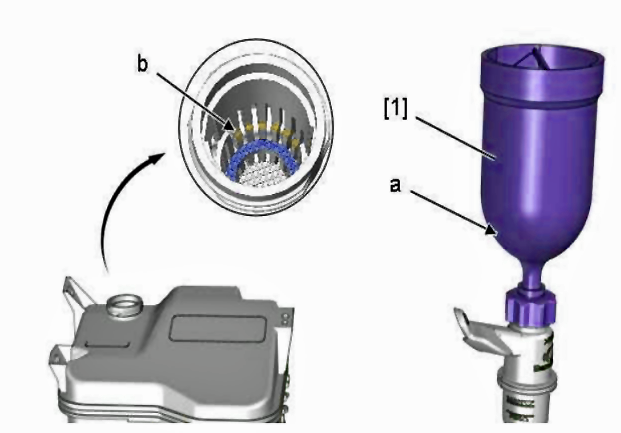

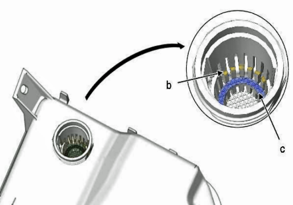

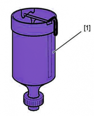

| Tool for Filling Metallically Suspended Systems Only |
- Use new oil for filling and topping up the hydraulic power steering circuit.
- Use only the hydraulic fluid TOTAL FLUIDE DA.
Remember: If raising vehicle off the ground with all wheels hanging freely and unsupported, remove the LDS cap from the suspension tank before lifting.
Lift and support the vehicle with the wheels free.
Disconnect the battery.
Remove:
- The front right wheel
- The protective panel under the engine
- The front right mud guard
- The cap of the power steering fluid tank

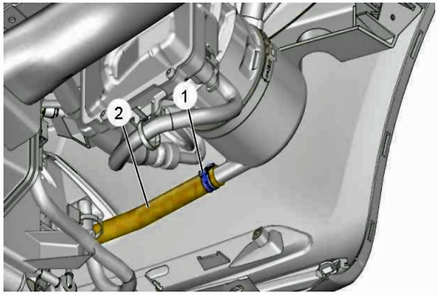

Draining
Couple the pipe (2). Refit the clip (1). Refit:
| Position tool [1] in its place (Metallic Suspension) Fill the fluid reservoir to the max. level ( as "b") (Hydraulic suspension). Refill the tank of the power steering electropump assembly up to level "a" of the tool [1] (Metallic suspension). |

Got the car on a ramp and changed the seals on the pinion pipes (see how long they stay sealed).
What fun
Also replaced the steering gaiters even more fun
Managed to check front brakes and they'll survive for a bot longer. The rear bakes will last the winter but will need replacing in the spring.
