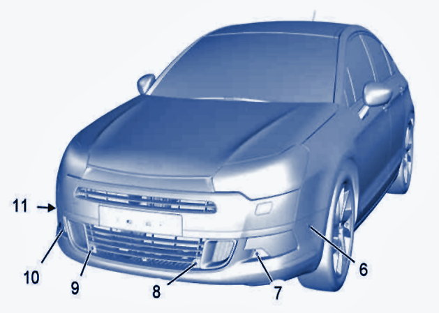

Just to make sure: is the ”front left exterior” the one next to wheel or the one next to grill?

Ok, so I think you have changed the wrong one. The sensor that is faulty is number 7 - I think you have changed number 6.
(6) Left-hand available space measurement transmitter sensor.
(7) Exterior left front proximity transmitter sensor.
(8) Interior left front proximity transmitter sensor.
(9) Interior right front proximity transmitter sensor.
(10) Exterior right front proximity transmitter sensor.
(11) Right-hand available space measurement transmitter sensor.

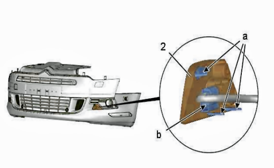

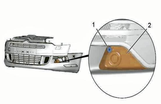

No you don't need to remove the bumper. See below: You need a torx bit for the screw, but I can't remember if it's a T15 or T20 when I did mine.
Remove: The proximity sensor support (2) bolt (1).
  • Unclip - Detach: The proximity sensor mounting (2) ( as "a"); Using tool [1].
  • Disconnect the connector ( as "b").
  • Remove: The bracket (Proximity sensor) (2)
So just undo the Torx screw from the support, then use a trim tool to carefully ease out the support at an angle using the picture as a guide. There are 3 plastic bits that support it - just be gentle so as not to snap them.

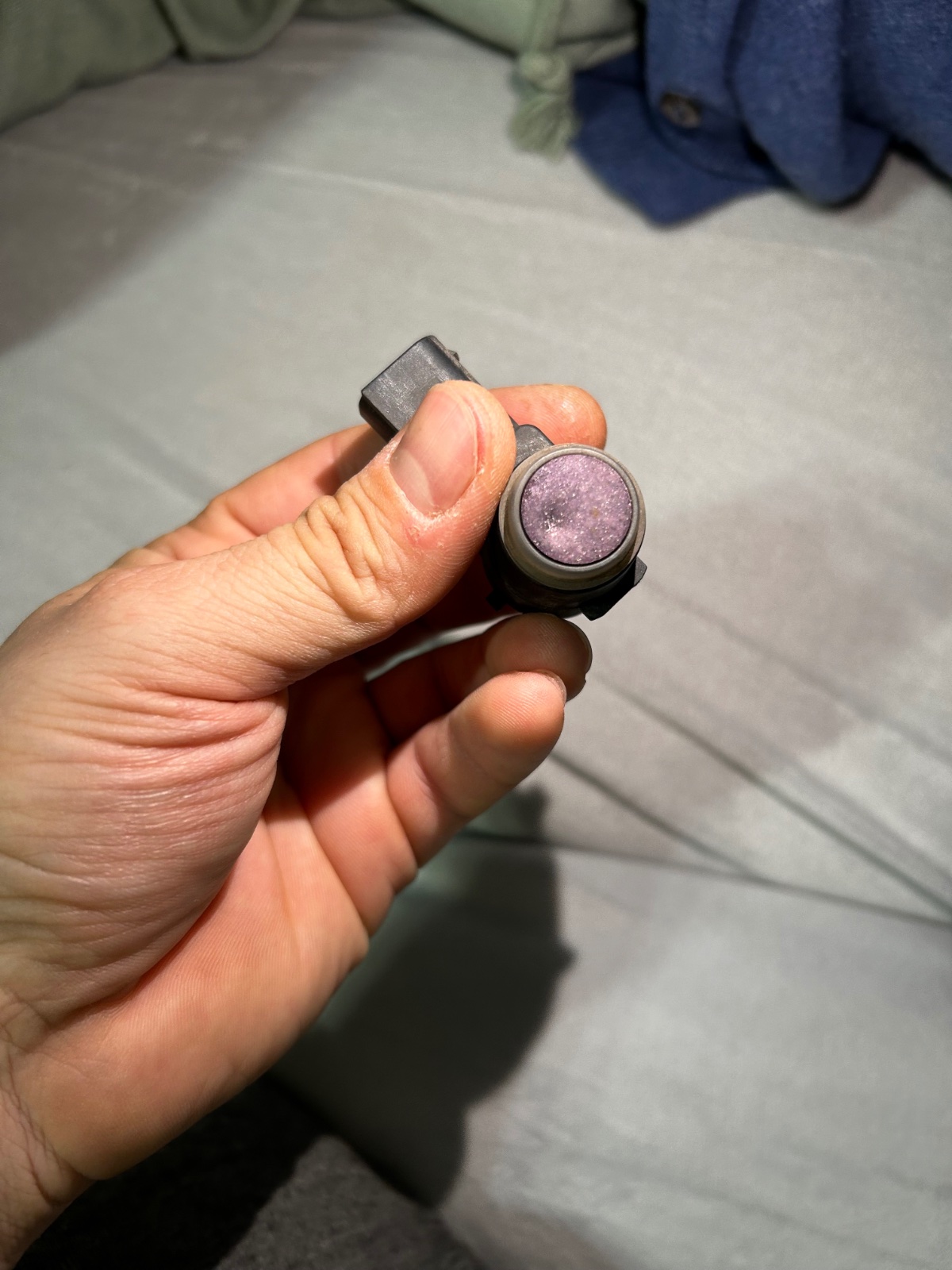

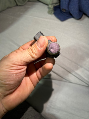

Exactly! Lot of time saved! Good luck for the colleagues with similar issue. On mine I have identified a spot which seems to be a stone hit.
x 6957
Re: C5 X7 Parking sensor front left exterior?
Yes, that will do it any for sure. These sensors are really sensitive to drops or any impact, so a chip like that will certainly do it.
