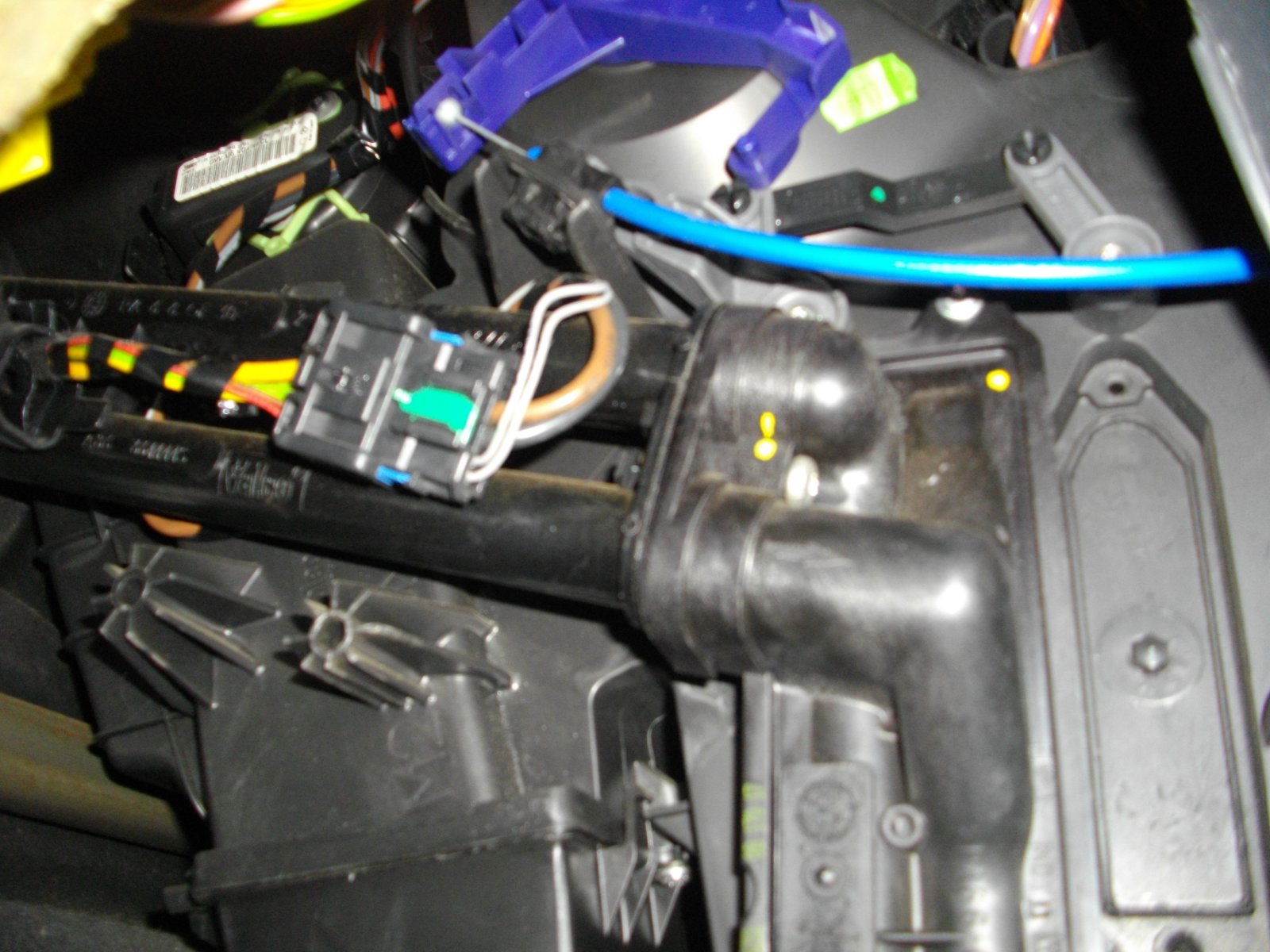

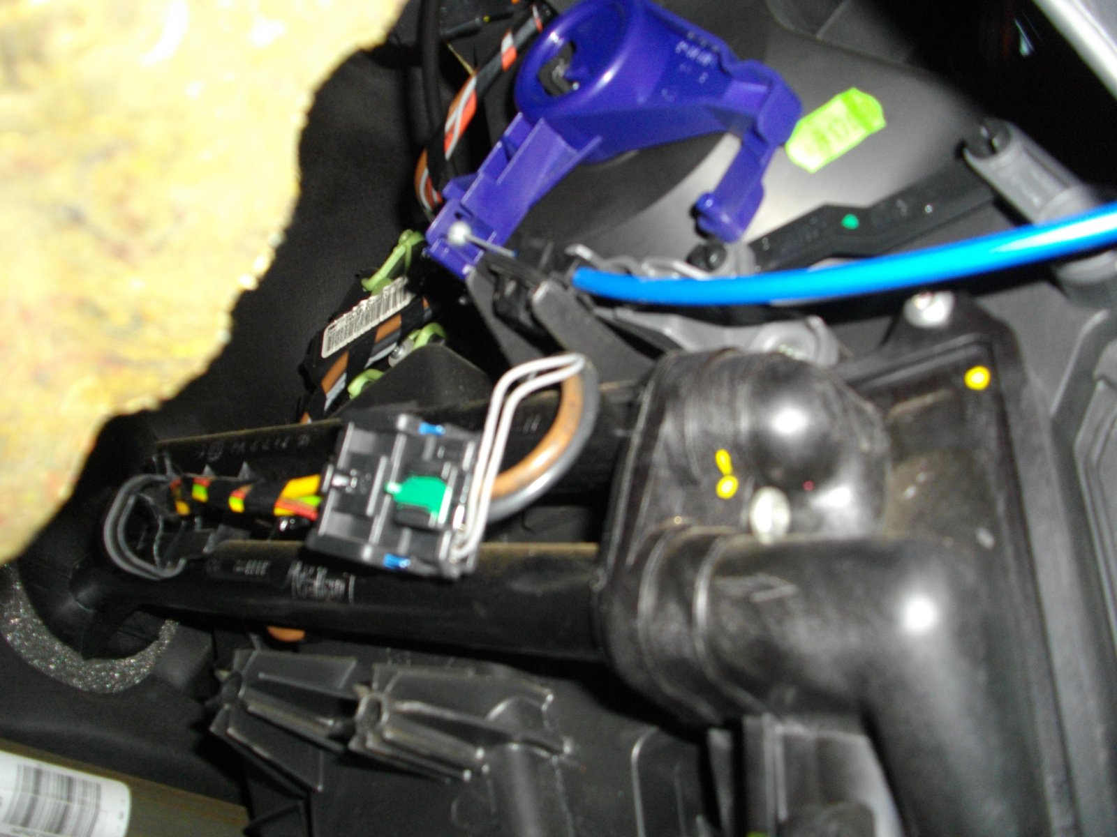

I've done a bit of dismantling but unable to get it moving - I presumed initially that it was a kinked inner cable as per Xantia but that seems not to be the case.
Removed the oddments bin thing and pulled some trim off the passenger footwell and can feel that the control does operate an arm on the side of the heater box, even seems to be at the limit of travel, but no actual warm air coming out.

Found the rather rubbish photos.
The blue cable operates the blue plastic arm that presumably moves a flap in the heater box.
It was working a few weeks ago when I took her car to have a wheel bearing replaced but has likely been returned to the cold setting in the meantime.

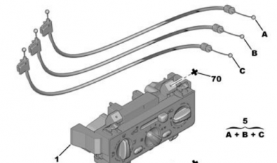

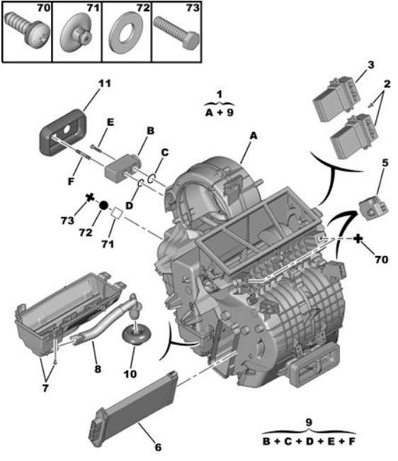

There is very little info on the heaters of these.
For your model the first diagram applies and shows the cables. On the second diagram, your C3 only has part (2) - the Heater Motor Control Module. It doesn't have parts 3, 5 or 6.
If the cables are operating, are you sure it isn't the heater motor control module (2) that is faulty? Remember this vehicle does not have the air resistance heating (6)

In a way Steve, the 'mechanically' as opposed to 'electrically' operated flaps should make it easy to eliminate failed motor units - as this one doesn't have any. If the cables are operating freely and are not disconnected, I can only assume that the either the gear cogs that the cables are working on are worn, resulting in the flap remaining in one position- but if this was the case I would expect the cable to be moving very loosely as there would be hardly any resistance if the gear cog was worn.
So if you try and pull the cable manually (as per your photo) does the flap move? I'm trying to ascertain whether the other end of the cable (the end in the control module on the dash) has got fouled up... in other words the control knob is turning, but not actually pulling on the cable itself. It might be worth looking inside the heater control panel to see if the cable has come out of the winder mechanism.

Turning the knob does result in the arm moving but only about ? of its full travel.
I was presuming that the cog that drives the flap had stripped but this is probably not the case. The arm is fully on the 'hot' end of its travel.
Looking more like the blower control.

Ok, well the part (2) is 6441Q8 Steve in case it's this - but it is VERY sensitive as the resistor is right at the end and looks very easy to break.
£74.58 from Citroen inc. VAT
A Valeo one here on the bay for £27.91: https://www.ebay.co.uk/p/CITROEN-C3-Act ... 1831014882
And of course even cheaper ones - but not sure of the quality of some of those - I guess it depends on how much of a pig it is to get at and replace as to which one you get!
