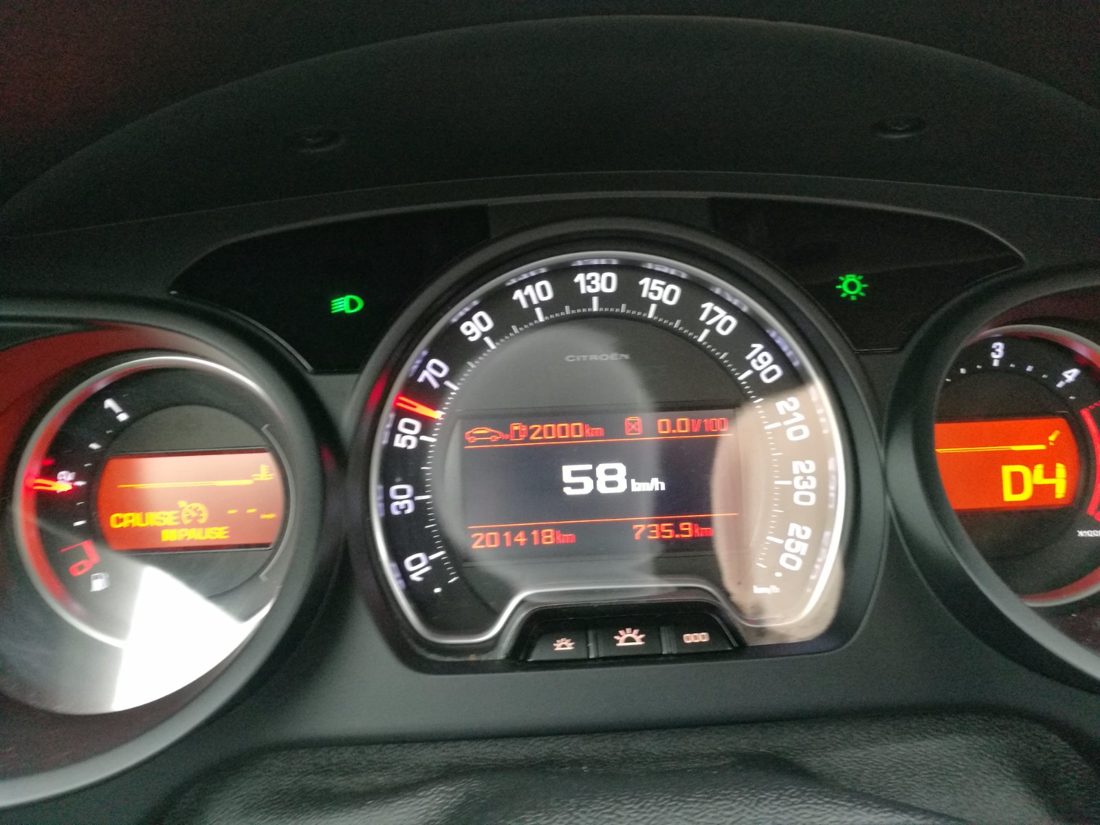

My C5 2,7hdi V6 2009 not show fuel consumption and how far i can go on the display , only meter working. Lexia not show something wrong

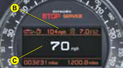

Ok, let's make sure you have the correct display showing:

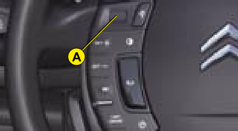

Using the Left Hand Wheel control will give you the Speed Display, then Trip 1, then Trip 2, Navigation, etc.
So can you confirm (bearing in mind you must be travelling over 30 KMH for some info to display) you are getting thee screens?

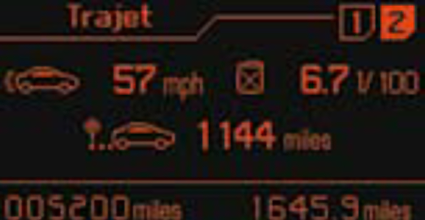

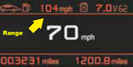

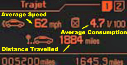

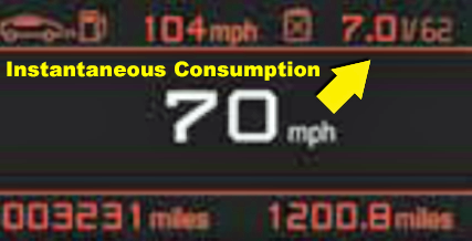

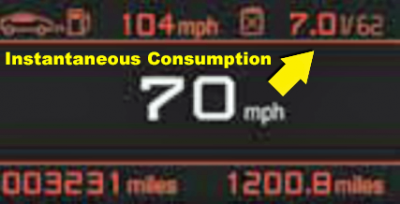

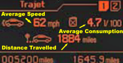

| Changed by rotating the left hand scroll wheel | Instantaneous Info in Zone B Zone C Display 3 types of Trip Info |
| With the SPEED display showing Range available on existing fuel is shown arrowed. Note: When Range remaining is less than 30 Km, 4 dashes display. | Instantaneous Fuel Consumption is shown arrowed. Note: only available when travelling over 30km/h |
| On any of the 2 Trip Displays This is the Info shown | The same for Trip 2 |

Yes I know the car have to travel 30km/h and the tank is full of diesel. The funny part is that range is stuck on impossible 2000km and not move. The car have always ben served at Citroën and they dont now why is like this.
